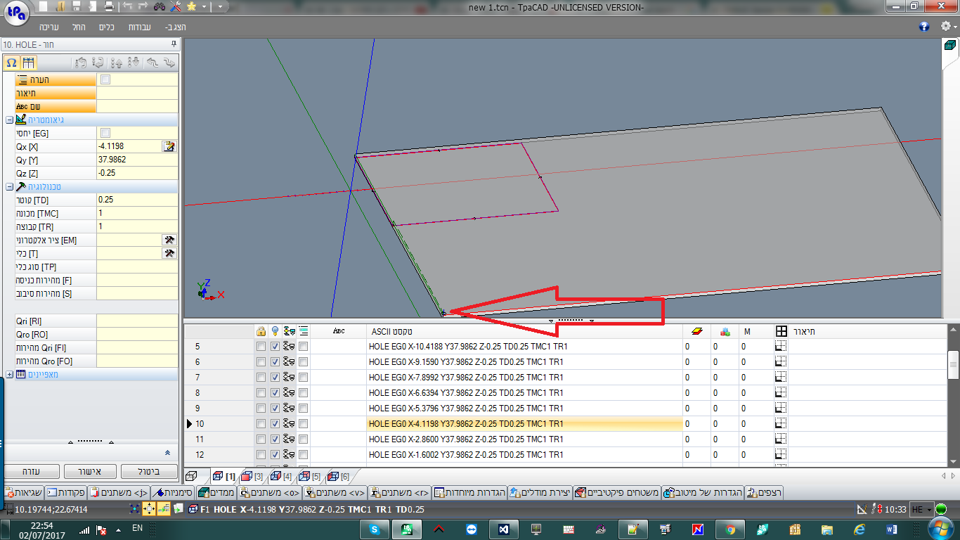

This is a view of the file in control editor.
View higher quality, full size image (1219 X 920)

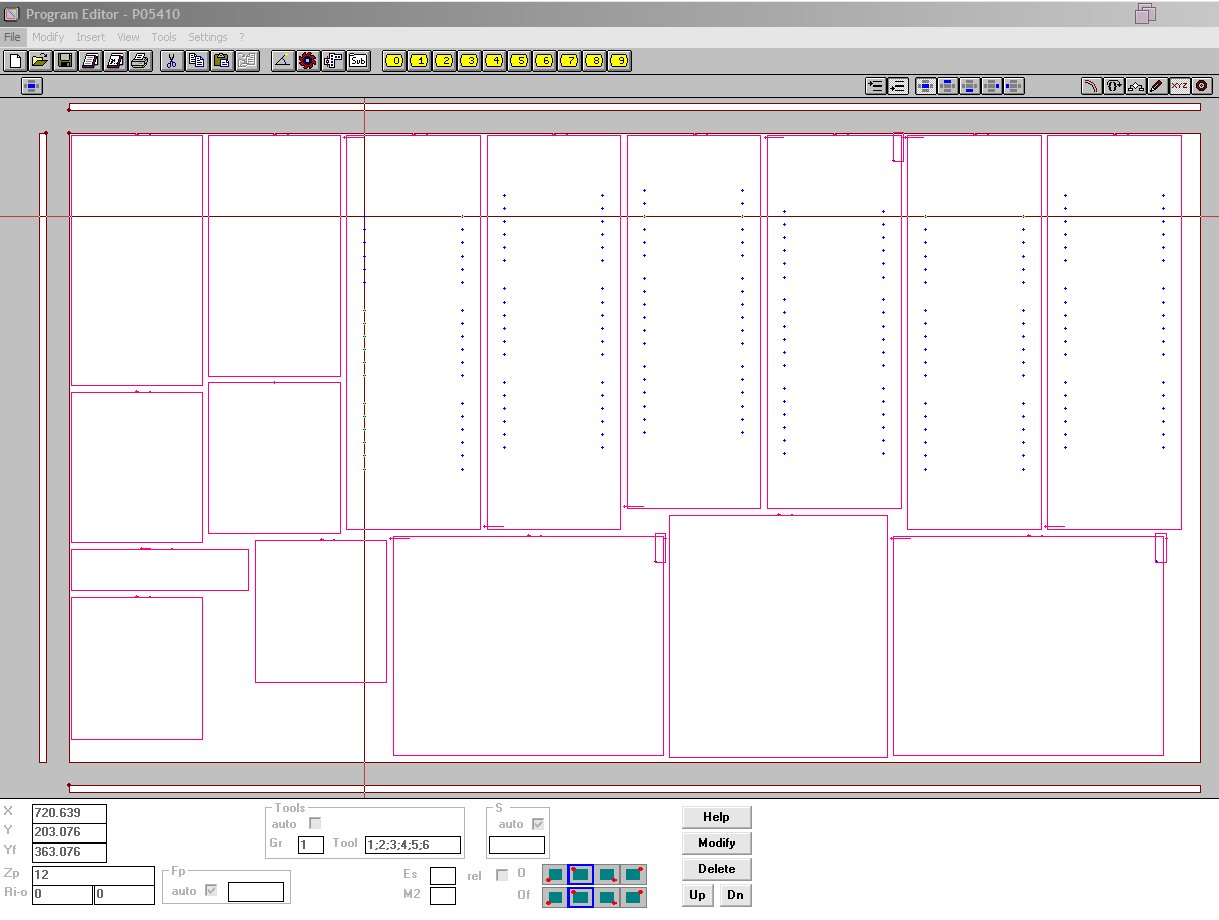

6/14/17       #3: Busellato CNC Code ...
Lee S Member
FYI when you use the control editor to print the file the text gets printed like this.
T.P.A. Spa - Genesis
prg : P05410 / 06-14-17 / 17:48:49 /
G71X2768.605Y1539.878Z19.05T00
G150(PATTERN 10 1539.8780)

0022.(Rh) G184G90G17P5T01010203040506X1749.716Y622.1764Z19.15J782.1764
0023.(Rh) G81G90G17P5T0117X2016.609Y64.75Z19.15
0024.(Rh) G184G90G17P5T01010203040506X1990.359Y190.3756Z19.15J350.3756
0025.(Rh) G184G90G17P5T01010203040506X1990.359Y406.276Z19.15J566.276
0026.(Rh) G184G90G17P5T01010203040506X1990.359Y622.1764Z19.15J782.1764
0027.(Rh) G184G90G17P5T01010203040506X2092.741Y660.2765Z12J820.2765

Lee:
Hmmmm...that is simply g-code, which is a heck of a lot easier than the code I shared above! I have never seen any code for Busellato except that utilized by TPACad, which is shown in my first post above. Is the program you use to interpret Busellato code part of your machine, or is it a program you have on your computer? If it is the latter, may I have its name so that I may see about obtaining it?
I am wondering if some Busellatos use the g-code you displayed, and some use code according to the format in TPACad.
At any rate, we are still in need of drill bank code samples in the language of TPACad. Thank you Lee.
Cabinetpro.com
6/14/17       #5: Busellato CNC Code ...
Lee S Member
Frank,
This program is run on the machine and can also be installed on a normal PC. It needs additionally a set of files that the manufacturer calls a "customs disc" which holds information about the configuration of the individual router that the user needs code for.
You may be able to get some help from casadei-busellato. My machine is a 2001 vintage and the control software for the new machines is more advanced. You may want to be sure you are creating a post for the correct machine. Genesis is the software provided and control editor the g-code writer and editor.
I have also gotten posts written and tweaked for my machine by the programmers and users of Vectric Aspire
http://forum.vectric.com/search.php?keywords=busellato&fid%5B0%5D=4
View higher quality, full size image (587 X 462)
http://www.casadei-busellato.com/en

6/18/17       #8: Busellato CNC Code ...
katz Yaakov
frank
yours code is for Tpa controer or in usa its caled jenesis
the drill code is:
W81
like this:
W#81{ ::WTp WS=12 #8015=0 #201=1 #203=1 #1=500 #2=9.5 #3=-30 #1002=8 #1001=1 }W
6/18/17       #9: Busellato CNC Code ...
Frank D. Jimenez
Thank you Katz!!!! I will try it asap! Thanks again!!
6/30/17       #10: Busellato CNC Code ...
Frank D. Jimenez  Member
Website: http://www.cabinetpro.com
Katz, what does the WS parameter shown in your example represent? I have looked in the TPACad manual but was unable to find anything in reference to WS.
Thanks Katz.
6/30/17       #11: Busellato CNC Code ...
Never mind Katz. WS refers to the tool number.
7/1/17       #12: Busellato CNC Code ...
katz Yaakov
ws is just name
#1002 is the diameter of drill bit
no nead tool name Tpause there optimizer
to find drill acording diameter
7/2/17       #13: Busellato CNC Code ...
Okay. Below is some code that should drill 12 holes with the drill bank. Do you see any problems with it Katz? I will be giving this new post to the customer tomorrow, so I really appreciate your input.

Does the following access the drill bank properly (w/#1002=0.25)?
W#81{ ::WTp
#8015=0 #1=-15.4580 #2=37.9862 #3=-0.25 #201=1 #203=1 #1002=0.25 }W
W#81{ ::WTp
#8015=0 #1=-14.1982 #2=37.9862 #3=-0.25 #201=1 #203=1 #1002=0.25 }W
W#81{ ::WTp
#8015=0 #1=-12.9384 #2=37.9862 #3=-0.25 #201=1 #203=1 #1002=0.25 }W
W#81{ ::WTp
#8015=0 #1=-11.6786 #2=37.9862 #3=-0.25 #201=1 #203=1 #1002=0.25 }W
W#81{ ::WTp
#8015=0 #1=-10.4188 #2=37.9862 #3=-0.25 #201=1 #203=1 #1002=0.25 }W
W#81{ ::WTp
#8015=0 #1=-9.1590 #2=37.9862 #3=-0.25 #201=1 #203=1 #1002=0.25 }W
W#81{ ::WTp
#8015=0 #1=-7.8992 #2=37.9862 #3=-0.25 #201=1 #203=1 #1002=0.25 }W
W#81{ ::WTp
#8015=0 #1=-6.6394 #2=37.9862 #3=-0.25 #201=1 #203=1 #1002=0.25 }W
W#81{ ::WTp
#8015=0 #1=-5.3796 #2=37.9862 #3=-0.25 #201=1 #203=1 #1002=0.25 }W
W#81{ ::WTp
#8015=0 #1=-4.1198 #2=37.9862 #3=-0.25 #201=1 #203=1 #1002=0.25 }W
W#81{ ::WTp
#8015=0 #1=-2.8600 #2=37.9862 #3=-0.25 #201=1 #203=1 #1002=0.25 }W
W#81{ ::WTp
#8015=0 #1=-1.6002 #2=37.9862 #3=-0.25 #201=1 #203=1 #1002=0.25 }W

katz Yaakov
you can see attach yours program
first about the tool path is it ok ?
about drill why its on minus x?
View higher quality, full size image (1366 X 768)
