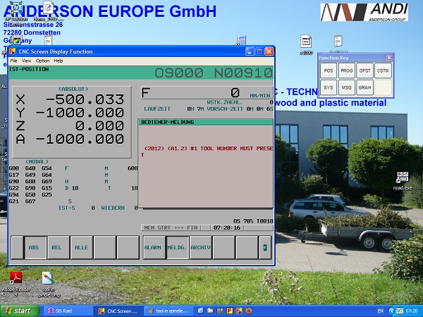

im new to this controller and even i have lot of experience with other controller,with this i cant found simple thing how to do,
1. i need tell controller which tool is present on magazine (i got the error"Tool number must preset" i guess its because that)
2.which tool is now in the spindle
3.stop the program and start from start
thanks

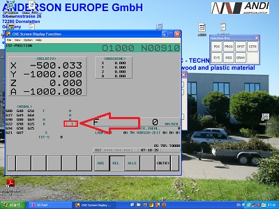

1. Go to MDI type in M97 T???; insert it & press CYCLE START (? = what tool is in the spindle. ie. M97 T103. If there is no tool in the spindle the code will read M97T100.)
2. Now type in M94T???; insert it & press CYCLE START (? = what tool is facing the spindle. ie M94 T102.)

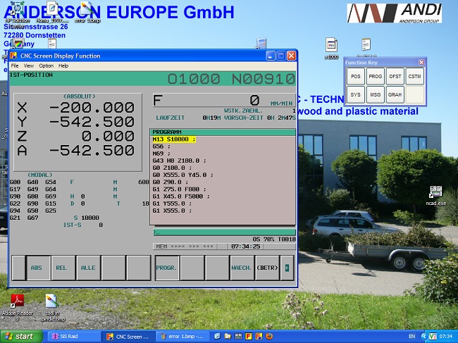

Thanks alot ill try tomarow,how do i restart program after stop inmiddle?
7/3/17       #4: Fanuc Anderson ...
clos
change your dial to edit, on the hard keys hit cycle stop(white key), cycle reset(blue key)
