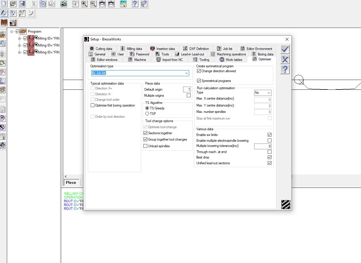

I would like Biesseworks to Optimize in the same order that I made the program but right now is optimizing randomly. I believe it is doing for time savings but the order that is doing it may cause one of the smaller bits to break and I don't want that to happen.
Anyone know how to set this up.
I am able to do it with BiesseNest but when doing a single program I haven't been able to figure it out.

put your password in and go into settings and then the optimize tab. I believe it should say by job list
Let me know how you make out
you can always call biesse they are great with support
