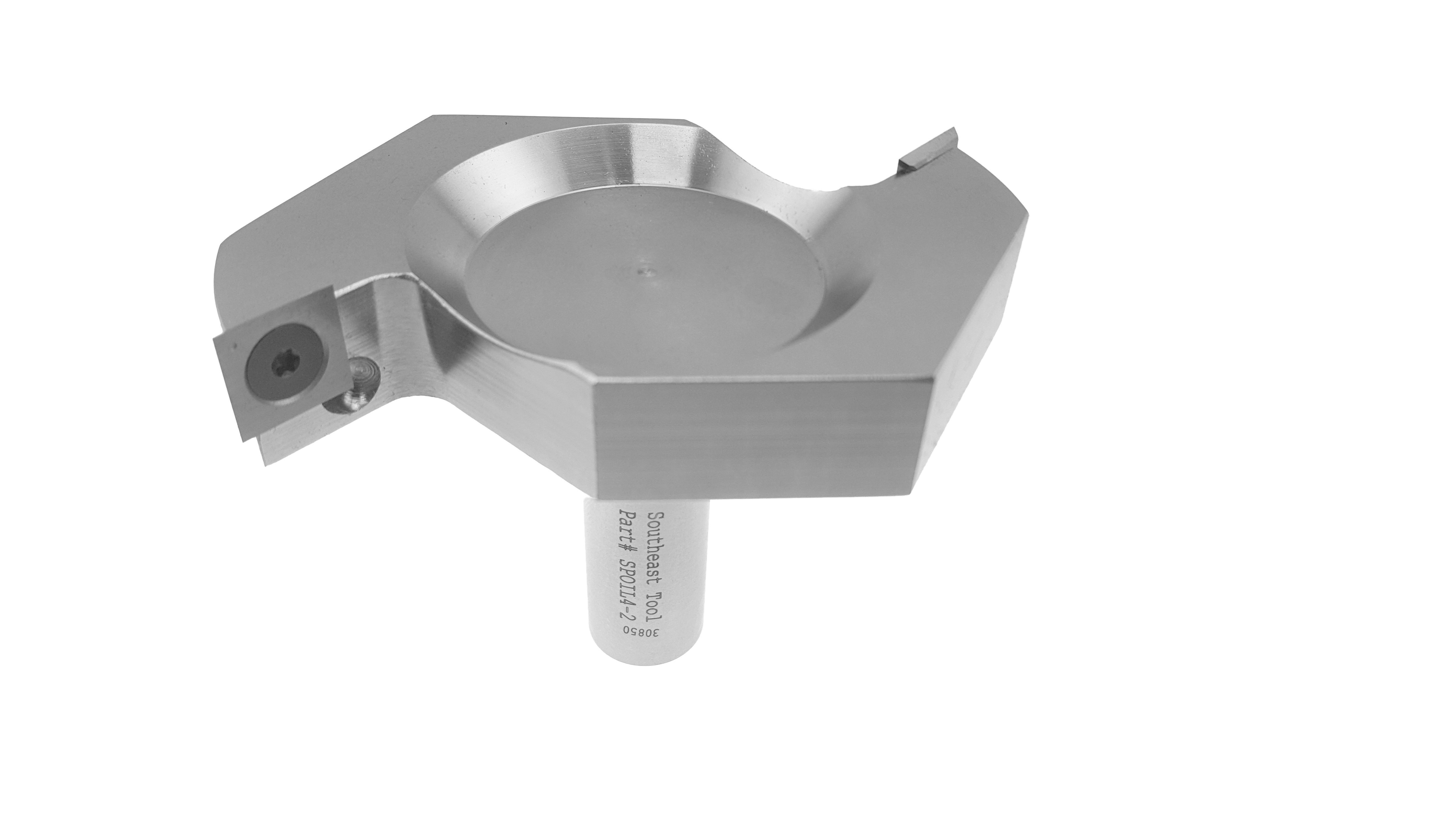

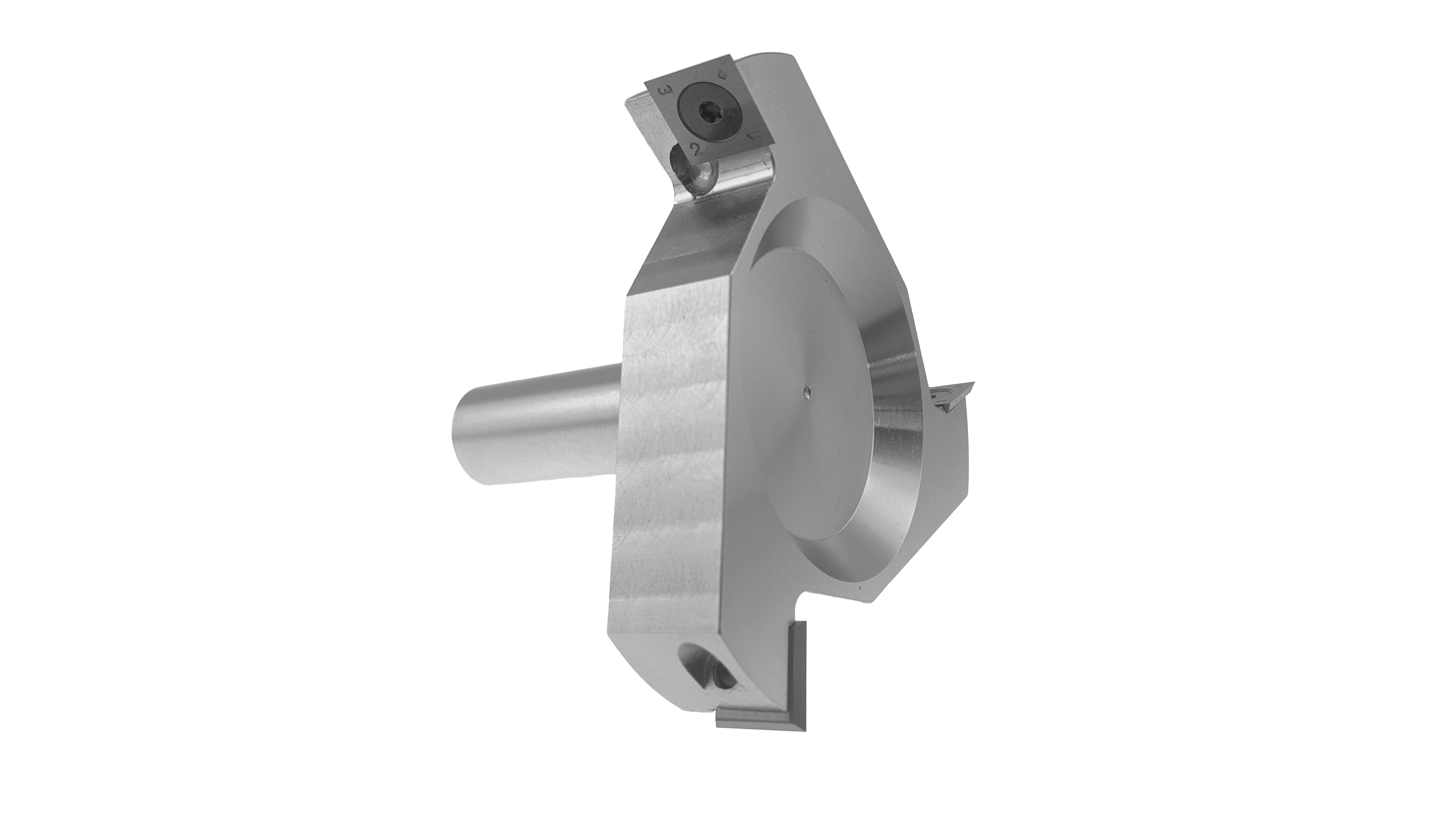

Thank you B, We are the company that is supplying those to US Router. We do have these from 1 7/8 Dia to 4" Dia, with some of those with 3 Wings also. We use the 4" dia x 3 wing on our CR Onsrud here at SE Tool for our machine and spoilboard and have had great success with it.
View higher quality, full size image (5312 X 2988)
