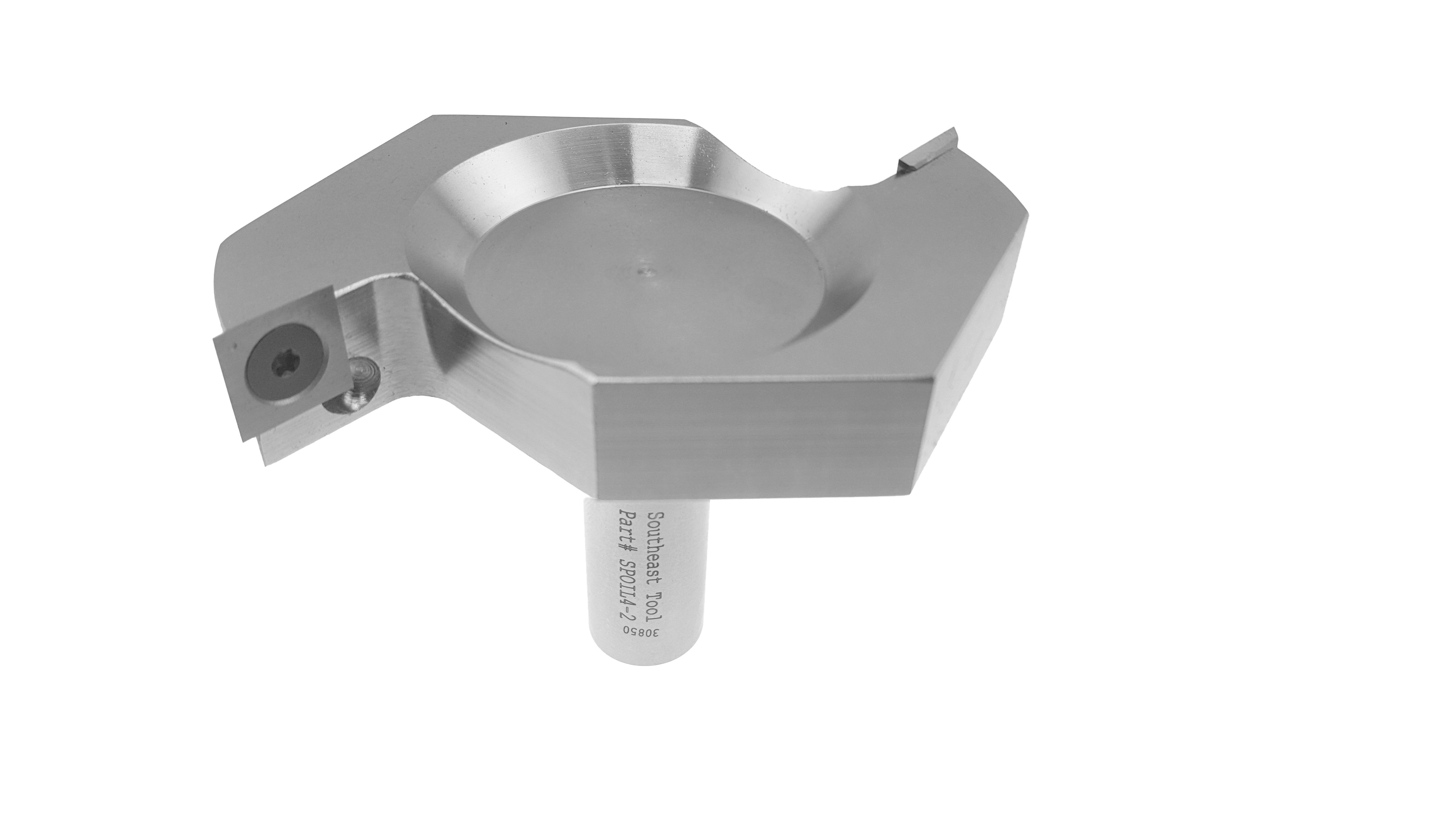

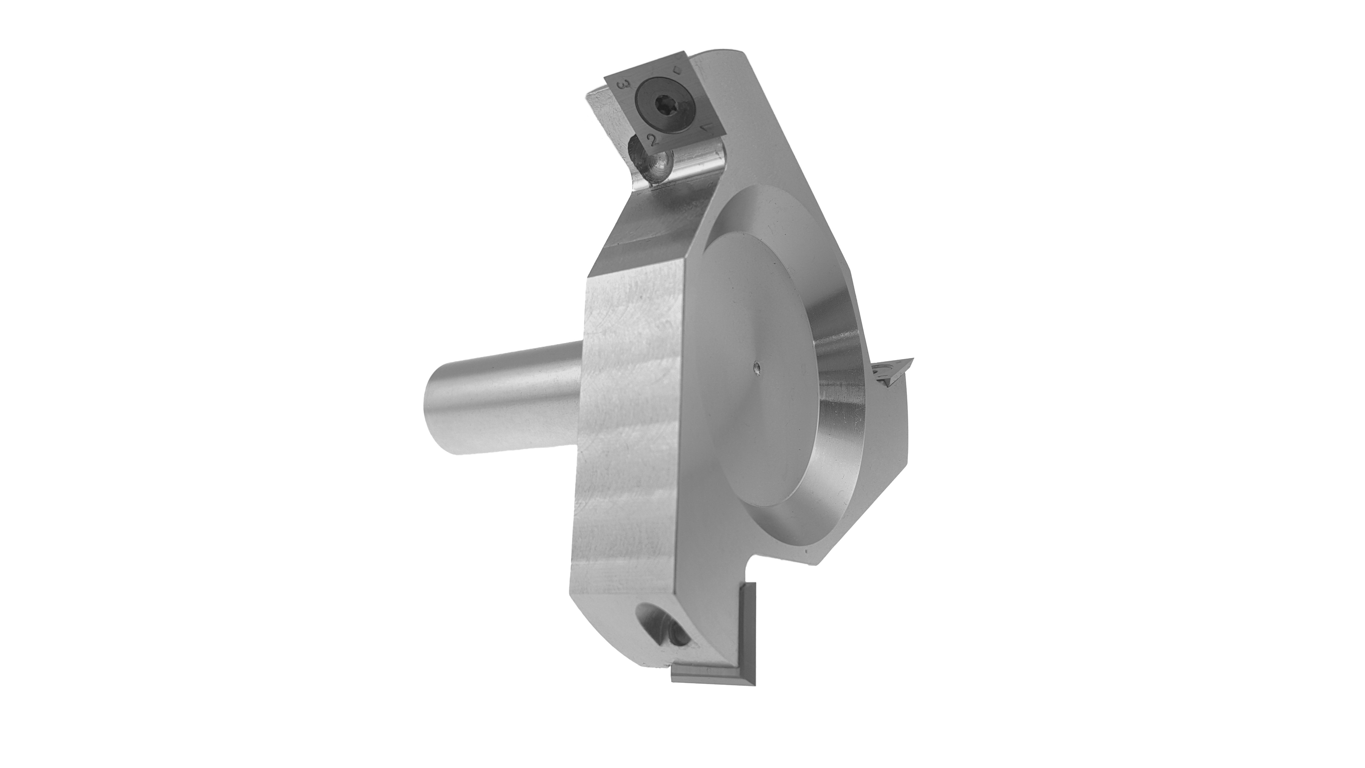

We can certainly make it, but I think a 1/2" Shank would do just fine unless you are really removing a lot of material or running a very high feed rate. We have the 3/4" Shank but its in a 4" dia.
View higher quality, full size image (5312 X 2988)
