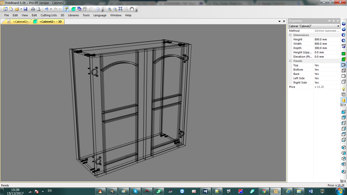

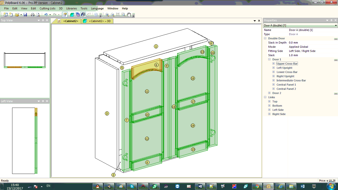

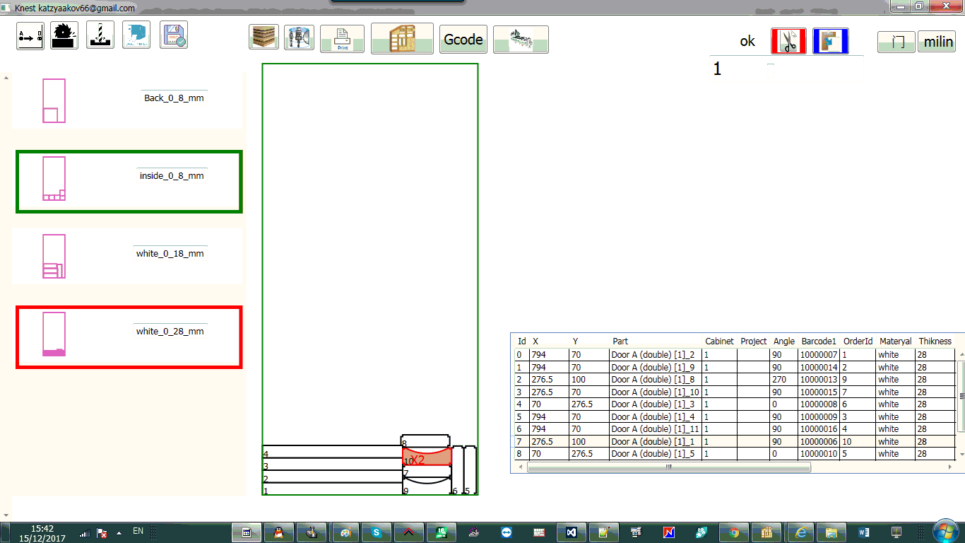

katz Yaakov
we can do it very easy one click with
polyboard + knest
View higher quality, full size image (1366 X 768)
