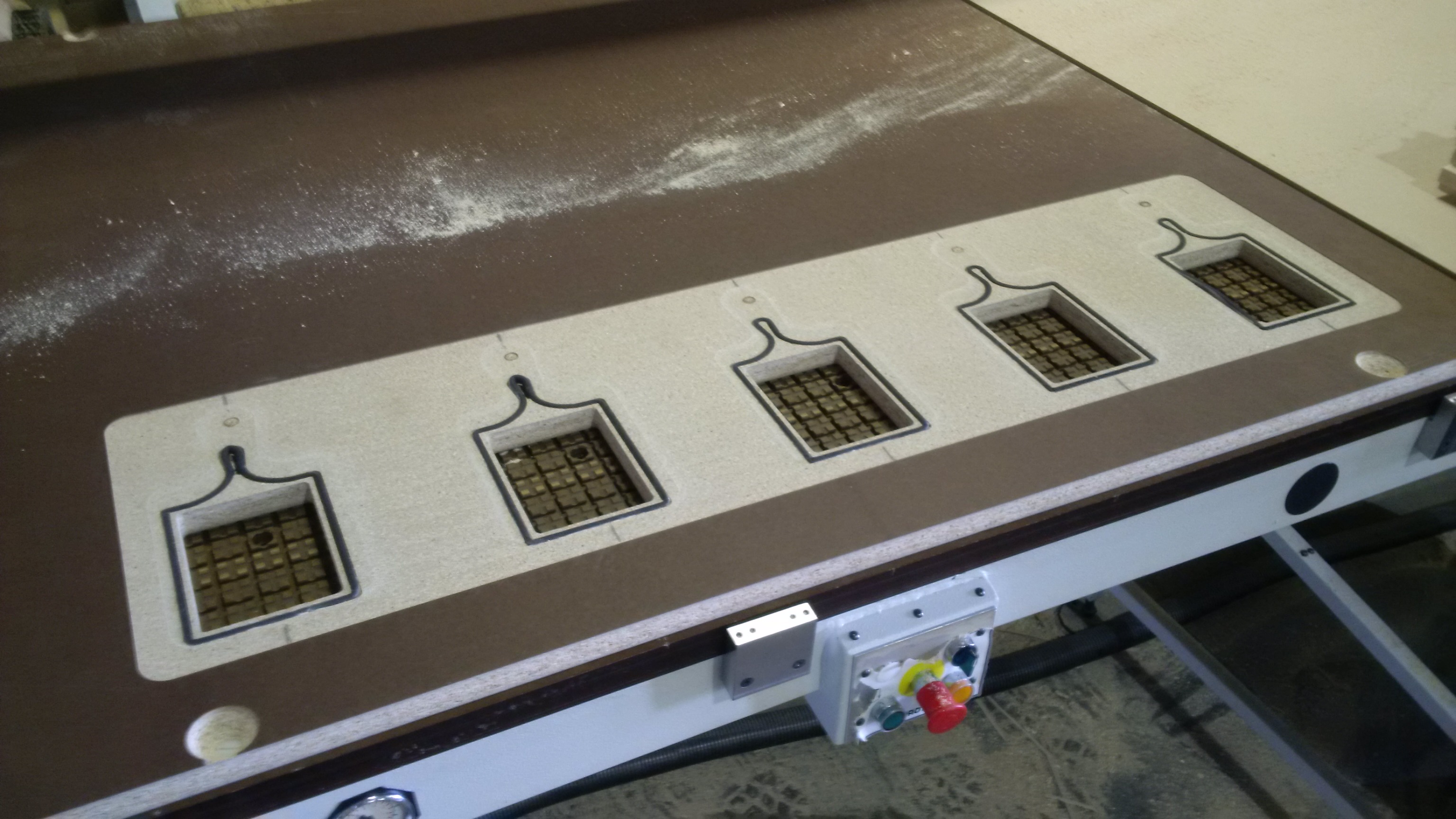

cabinetmaker
depends on how tall the part you are machining is
we screw parts down to a sacrificial piece of melamine and alter the spoil board thickness all the time, then process a test or two to make sure then let it fly

may i get a picture of your way if possible
1/7/18       #4: Cnc flat table spoilboard and pods ...
a.g. Member
do u think i can do something like that and insert my pod inside ??

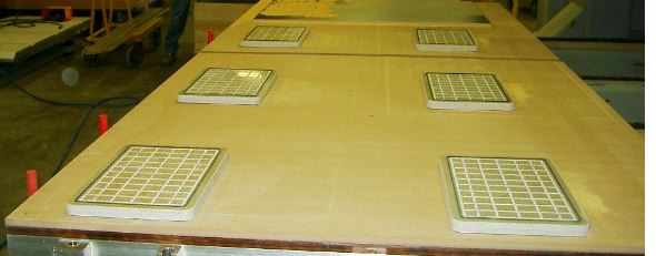

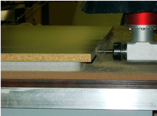

If your part is big enough, you can place shop made pods directly on the spoilboard without screws or other mechanical fixturing. We have pin extenders to make the reference pins tall enough to use with the pods. It all depends on what you are trying to accomplish.
1/9/18       #6: Cnc flat table spoilboard and pods ...
Solid surface pods sitting on bleeder board is enough to hold parts

Under this borad pods is empty right??
1/10/18       #8: Cnc flat table spoilboard and pods ...
Not sure I understand the question. The pods are just placed on top of the MDF bleeder board to elevate and hold the part. When done with the programs, just pick them up and go back to standard nesting programming.
1/10/18       #9: Cnc flat table spoilboard and pods ...
Anthony g g
I think i misunderstood bleeding board
Is it spoilboard ??
1/10/18       #10: Cnc flat table spoilboard and pods ...
Yes, that is correct.
