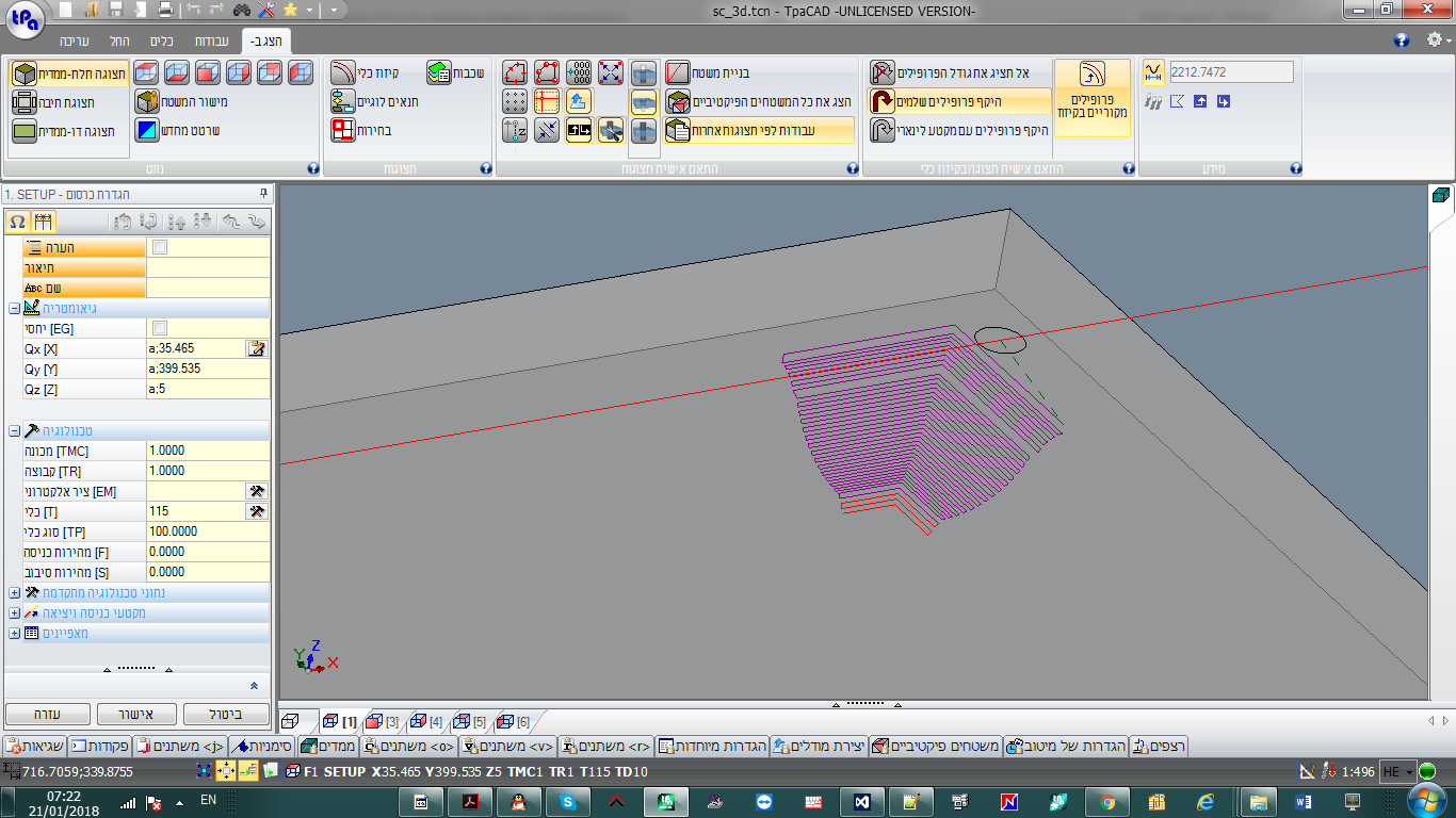

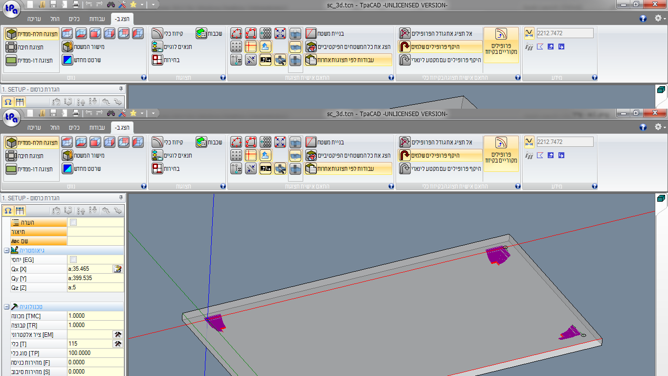

knest is mine software ,its mainly create to import the parts from Polyboard ,nest,optimise, and make many opertaion to make work much easy
like cut order the parts ,calculate best entry point(to keep parts as posibole conect to main board)
and also rought Mdf doors directly from project included sharp corner in some method
if you want more details send me mail
ill send you some video
** knest can connect ANY type of cnc
included divied the working into 2 cnc
or auto labeling
