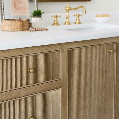

Hi All,
I have a customer who wants to make a small quantity of doors like this using his CNC. The doors will be Ash with a light stain.
Any tips on how to go about this? Or is this something that's best to outsource?

The cutting is relatively easy on a CNC router. Just back and forth with a point cutting round over bit (https://www.amazon.com/Whiteside-Router-Bits-1572-Diameter/dp/B000ALY4EC) .
The real catch is what to use for the material.
Solid ash is going to have way too much wood movement over the overall width of the doors.
Ash veneer panel stock isn't going to end up with any ash left at all on the surface as it is going to be machined away by the bit.
The next logical thought is a thick shop made ash veneer over a panel substrate. This sounds good but the panel will not be stable as the ash "veneer" would act as solid wood instead of a true veneer layer.
I don't see a solution offhand but perhaps someone else will chime in with a good idea.

Shop made plywood to the rescue. Same thickness of solid on the back as on the front. 5 ply, at 3/4" total thickness. Two .20" faces, and three plies of .117" with the grain alternating. The cock bead will cover the plywood edges. If you are worried about warpage, make it 7 ply at an inch thick.
I will bet lunch that it will not move a hair if it is 3/4" shop ply. There is far too much fear of warp passed around on the Forum (like a bunch of old women - is that sexist?). The real warp that is posted/seen is easy to diagnose and avoid. If I lived in fear of warpage like some, I would not be able to cut a board. My opinion.
I have made 'reeded' parts for years in 3/8" thick material on the shaper with a 4 bead cutter at 1". So I run 2" wide stock twice and then cut to length, butting or shiplapping the joints. Running it cross grain, unbalanced on friezes, etc, it never opens up and looks fine. Use quartered stock to help you sleep.

As heavy as the glaze is on the panel, I'd glue shop made veneer on mdf. Let the glaze disguise the seam and soak into the mdf. It would take some experimenting to see if a balance sheet is needed. If you cut all the way through the shop made veneer, I don't think the backer would be needed since the beads on the face has now become a row of pieces and expansion and contraction would not be an issue. If you use rift sawn ash, tear out would not be as much as an issue.

Or just run some bead strips, cut to length and glue them all onto an MDF backer. Apply true ash veneer to the back and band the edges with solid ash.
Voila............exactly what he's looking for with, as you said, no expansion/contraction issues.
