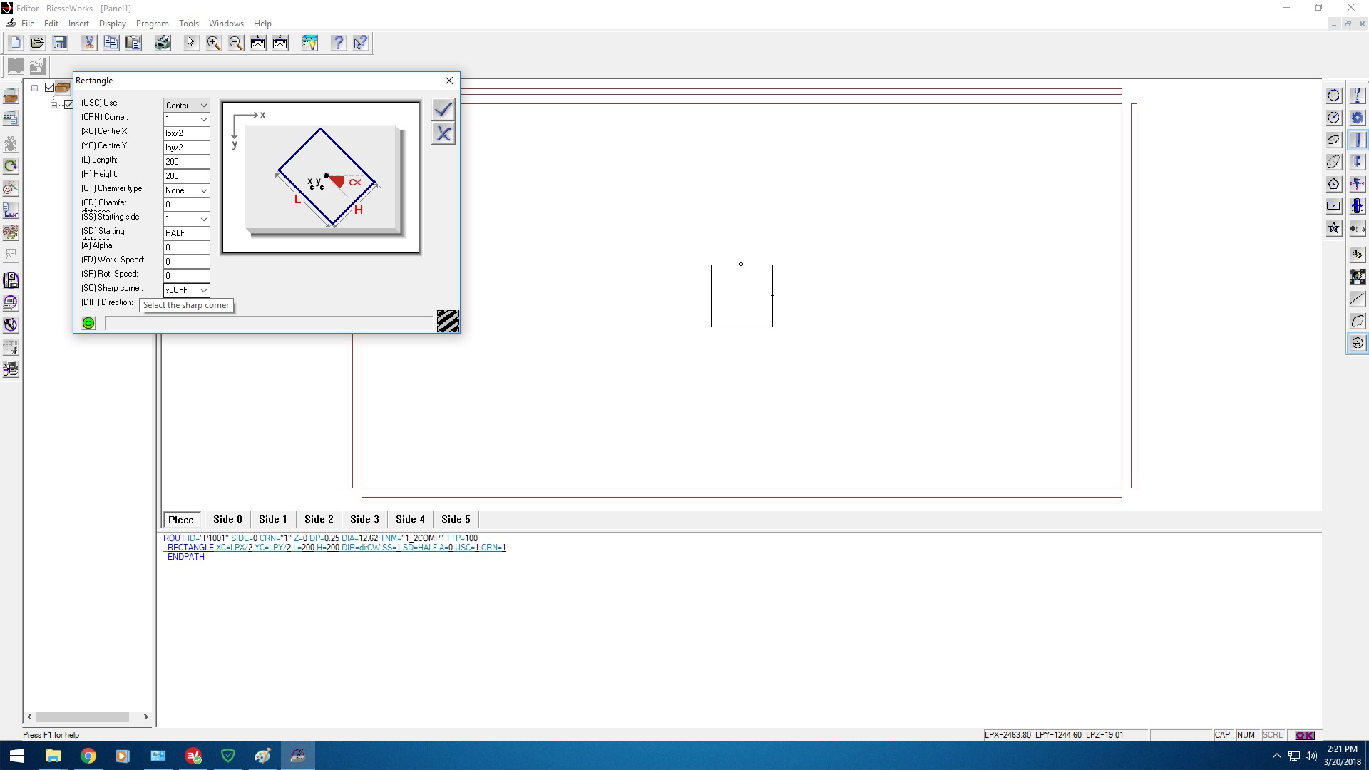

Chevy
After your geometry is in biesse works,,you can select “sc” sharp corners,,,if you need help I can make a video for you.
3/20/18       #10: Question on biesse work sharp corne ...
Chev
just did a training class ,,,take a look at this photo that shows the "SC' sharp corner function
9/3/24       #12: Question on biesse work sharp corne ...
KARAN
I'm importing file as dxf but my rectangles are showing as poly line cant find shrp crns option on bsolid.
