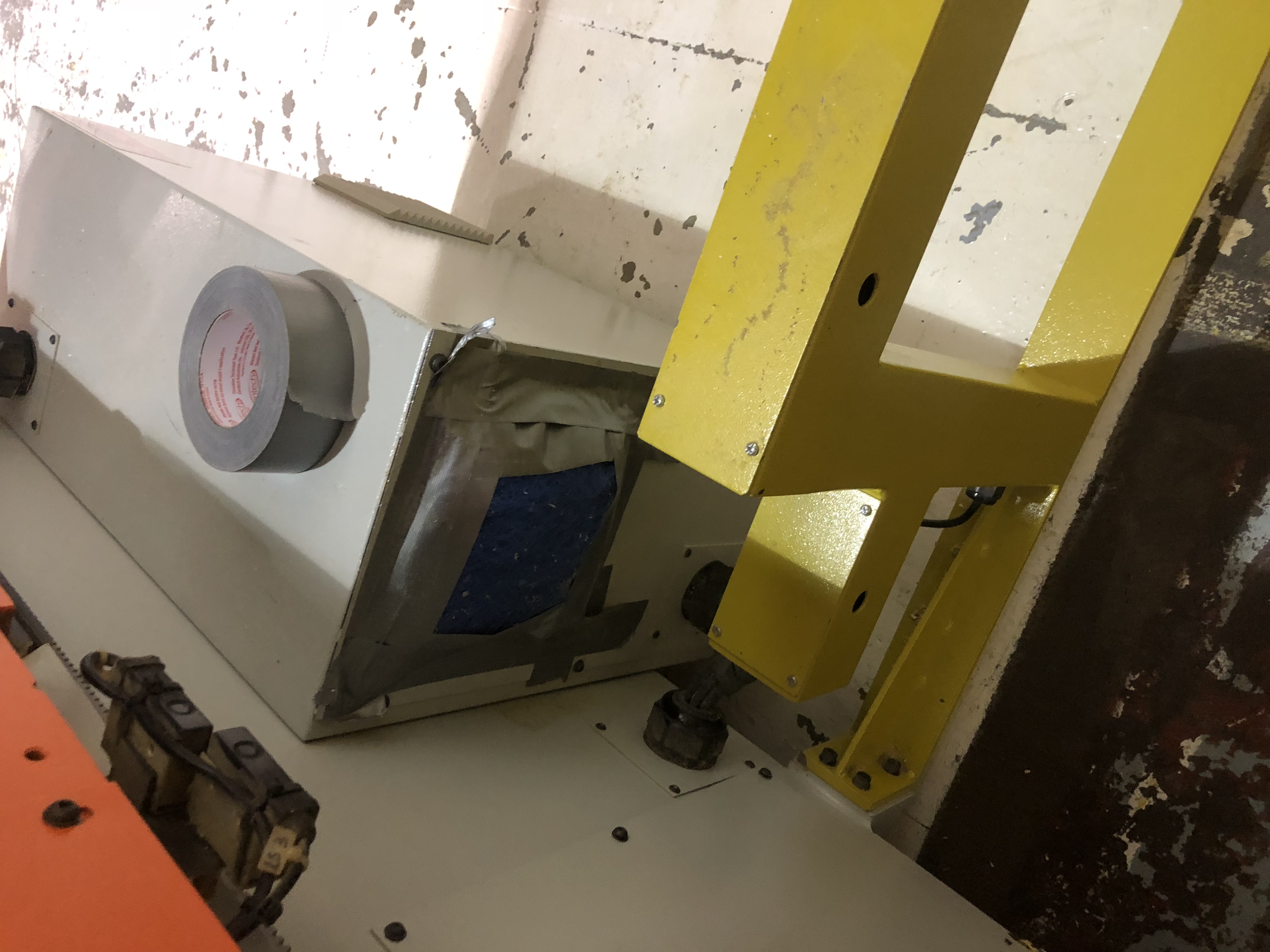

Hi Folks, has anyone experienced this? Dust ingress to the CPU on your CNC? So far I just duct tape a filter over the cooling fan housing, but it keeps coming off from the compressed air we use to blow sawdust off the machine. Thanks for any suggestions.

If you don't want to blow it out every few weeks, build a box around it and duct in some air from somewhere cleaner. Keep positive pressure in there to push dust out.
