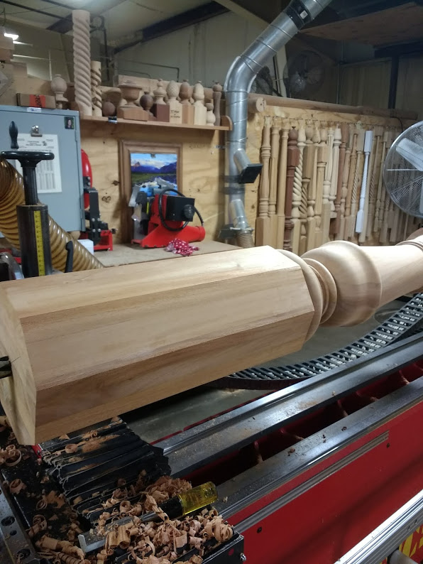

We have a wema cnc lathe / mill that I would like to get more capability from. It came with conversational software that functions extremely well for turning and basic milling profiles , but it has a rotary indexing chuck ( or lathe dog option) that I would really like to be able to use to it's potential. We do alot of ornamental flutes and twists , but I would like to be able to carve with it also. We have Alphacam ultimate that we are using for our 5 axis machine ,and this lathe's software is paired up with Megacad, which I love the functionality of for turning profiles. I don't want to lose any capabilties that we already have, so I would like to be able to do both if possible. Alphacam's drawing features leave alot to be desired. The tech end is not my specialty, so any advice is golden, thanks.
View higher quality, full size image (596 X 794)

more stuff from the machine
View higher quality, full size image (1076 X 807)
