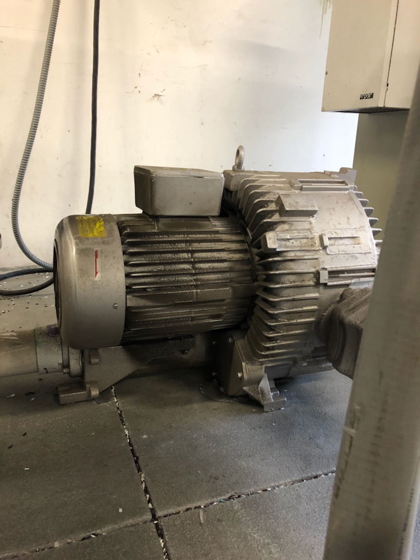

Yesterday while I saw a blower setup where the pump had a filter in place to prevent chips from getting to the pump. Great plan but the person had tee'd the main intake off and air from behind the machine could bypass the filter and go straight through the pump. It's a 4 inch pvc pipe going to the machine with now 4 inches open also. Needless to say there is better vacuum when the tee is removed and not allowed to bypass. Is it safe for the blower system to not have this additional unplunmbed in the system. We get a lot more hold down when it's plugged. Just concerned the pump could get to hot. Any advice would help.

Not 100% sure what you're talking about, but I think you are referring to the pressure relief.
On that T you describe, there should be a relief valve, then a filter that is open to atmosphere. When the pump hits max vacuum, the valve should open slightly to take filtered air from the atmosphere so the pump does not operate beyond its capacity.
Pumps are only rated for a certain amount of vacuum. Go beyond this and you could damage the pump. The relief valve is there to prevent damage.

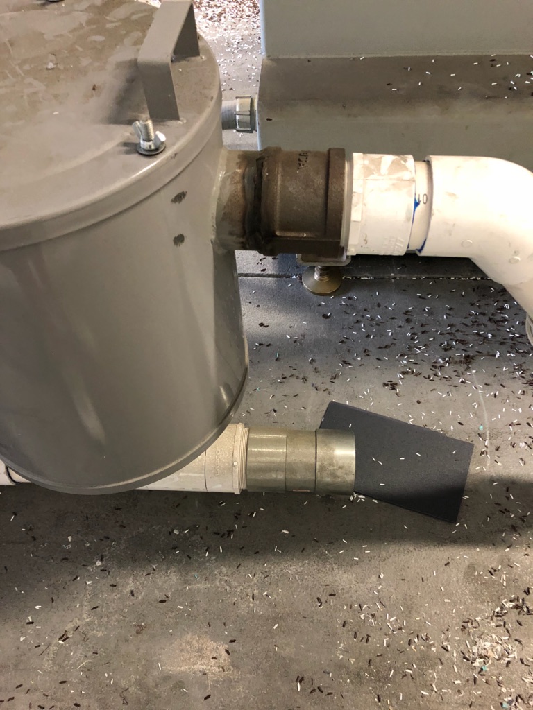

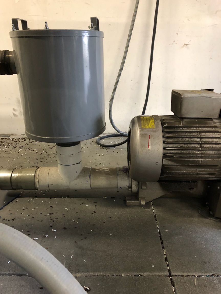

Here's what is really there. This pipe is unrestricted no filter ever seen this?

That looks like the place the pressure relief and filter should be.
Image in the link shows the pressure relief and filter on the right side of the T.

Is the end of the silver piece open or does it have a mesh?

The big one looks like the filter housing off the main hose from the cnc bed.
Doesn't look like it has a relief valve or a filter for the relief valve. If this is just open no wonder it doesn't have much vacuum.

Thanks for all the input. There is no filter just a cap with holes in it. This thing sounds like a train. So I think we should measure the temp open for an hour and capped for an hour. Sound like a good approach?
