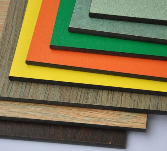

hi all hope your doing great
i got some work to nest some hpl boards for exterior wall cladding
Any tip about what type of cnc bits to use ?
thank you in advance
View higher quality, full size image (550 X 496)

What's the core?
6/10/18       #3: hpl board ...
daveguru
I assume solid HPL? [Phenolic]
-Tough on router bits, If you have to nest use diamond tooling, If just panels, I would saw.....

anthonyG Member
Thank you for your response
its Phenolic core Trespa brand .
So it can be done by cnc .

cabinetmaker
Run some tests and get a chip load calculation going.
We consulted Lucas @ Vortex Tools and I am sure many others will help you
Excellent result- be warned - it is heavy
