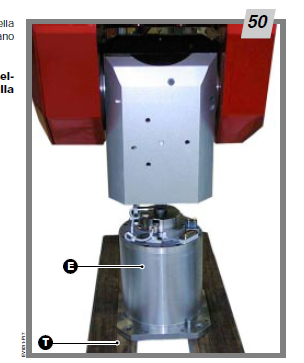

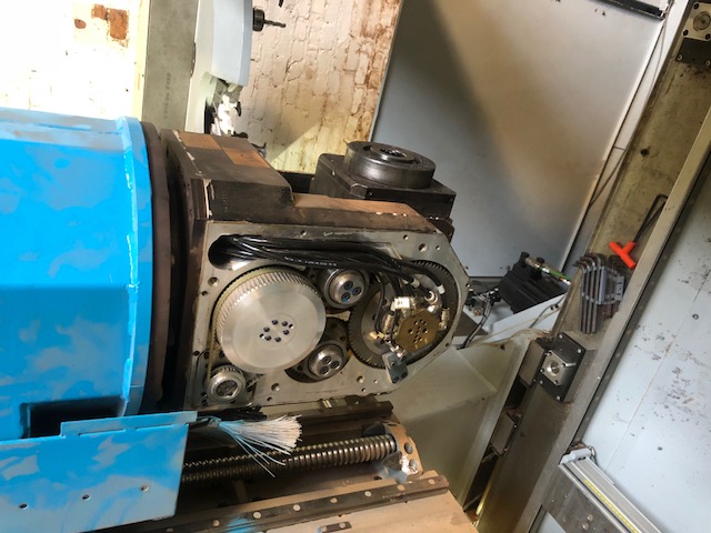

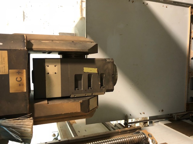

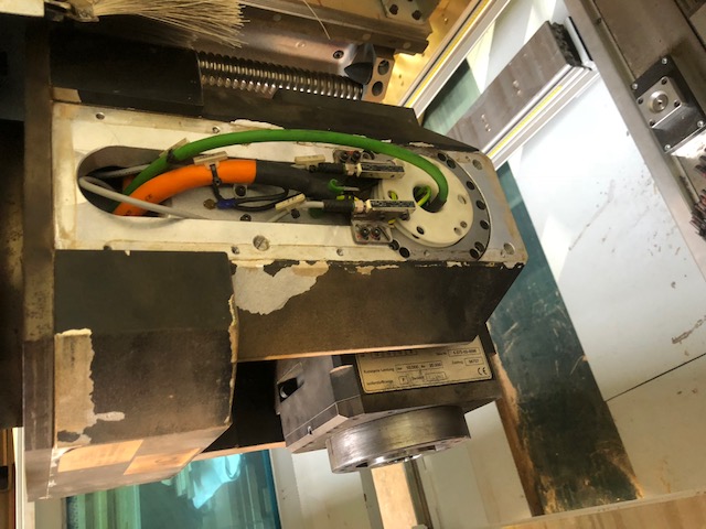

Does anyone have any ideas or know any tech in the NY area that can help me remove my 5 axis spindle from the housing.
Its a fork design (HOMAG)

6/27/18       #8: Removing 5 axis spindle For repair ...
Arto Member
Yeah, make somekinda bed for the spindle, manually move it so it touches the bed. Open all visible bolts and eventually you will figure out how it's built :p

You might find it quite a learning experience.I have done the job on a Thermwood and between the manual and the explanatory videos in the controller it was time consuming,but not massively difficult.Re-aligning and calibrating the spindle is vital too.

Its a little bit more complicated than i thought.
Stiles do Not give any diagrams. I would understand if they don't want to give the spindle diagram but not the diagram of how its connected to the housing.

Is it possible that the spindle is a cartridge that removes from the housing? Eurospindle makes one similar to that, and the electrospindle just unbolts and removes from the housing. No adjustments needed after replacement. Not sure but just a thought.
6/28/18       #12: Removing 5 axis spindle For repair ...
AL Member
Yep i looked at that
Its not a cartridge style.
Taking out the bottom there is a ceramic ring
that is too risky.
