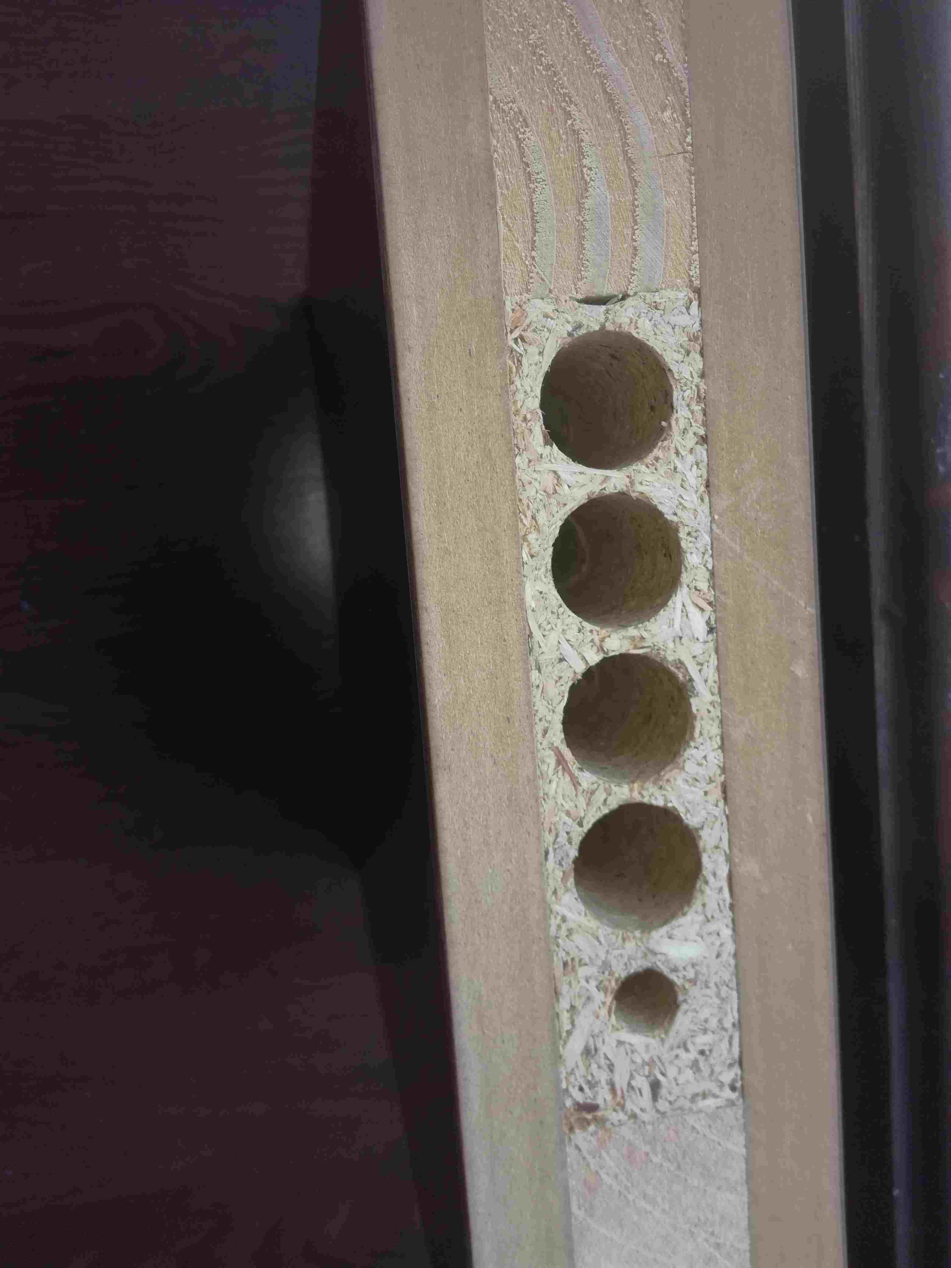

i got today a new job and its a big meeting table about 7m *4m
the inside of the table is in the picture i attached.
the table is made of
A-2 mdf boards of 1.8 cm each
B-particle board 3 cm and pine wood
i need to cut it using my cnc router and advice on what bit to get ?? its new to me to cut different type of wood any help will be much appreciated
thank you in advance all

Anthony,
What is the diameter of the holes and how deep are they?
7/19/18       #3: cutting thick wood ...
anthony Member
the holes in this picture a 2cm in diameter
and they are Hollow Chipboard so all the way deep
7/19/18       #4: cutting thick wood ...
3/4 compression spiral.
7/19/18       #5: cutting thick wood ...
anthony Member
is their a bit that is that long ?? i need a 10 cm bit i think or more
7/19/18       #6: cutting thick wood ...
I have one.
Came on a machine I bought :)
7/19/18       #7: cutting thick wood ...
anthony Member
its does not have to be a 7 cm cutting height
right

http://www.carbideprocessors.com/2-flute-compression-bit-3-4-dia-3-cut-length-3-4-
shank-southeast-tool-sud594/
7/20/18       #9: cutting thick wood ...
We can also do a spin back/down past the cutting edge to allow tool to go deeper without rubbing.

i need to cut all the way threw a 7 cm wood piece multiple passes for sure do i need a 7 cm cutting length bit?
