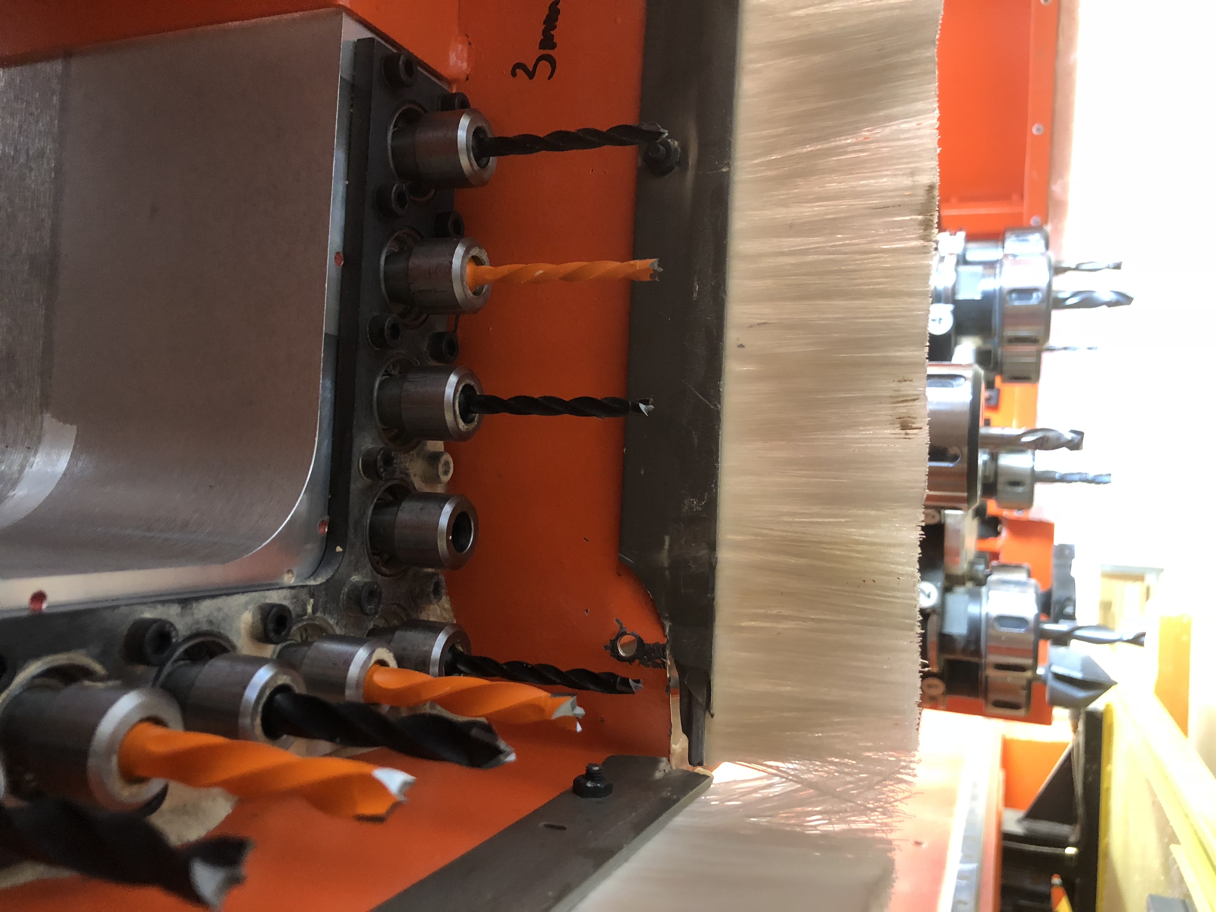

Hi all, our CNC has collars that hold 5mm drill bits. One of them is gummed up somehow so really hard to get a bit in and out. I've tried a poor cleaner and laquer thinner, any other suggestions?
4/19/18       #2: CNC drill bit holders ...
Gun cleaning kit with solvent and brass barrel brush. I haven't owned a gun since I was a teenager on the farm, so can't help you with sizing.

Just had this same issue last Saturday.
Old bit slid out, new one wouldn't go in.
Measured everything 10 times. new bit was, if anything 0.001 small in diameter.
Tried it in another spot, no problem.
I ended up polishing all edges of the new bit with the belt sander and in it went.
