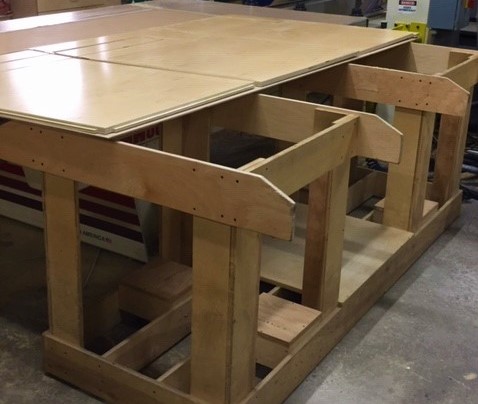

12/27/18       #10: Onload/Offload ...
Dave Member
Website: http://hallsedge.com
In addition to our MDF spoil board we use two (2) removable MDF waste boards. A waste board is placed on top of the spoil board and the material being machined is placed on top of the waste board.
At the end of a cycle the entire sheet of parts and the waste board is dragged onto a shop-made rolling cart, that the operator walks through the center of. See pic.
After a quick blow off of the (mostly clean) spoil board, the second waste board is loaded, along with a new sheet of material, and the machine goes back to work. While the second sheet is being machined, the parts from the first sheet are labeled and stacked, and the first waste board is cleaned.
With a little practice (and hustle), most operators can do a sheet change in under 60 seconds, and for most sheets, all clean-up is performed while the machine is working on the next sheet.
Waste boards are machined on two faces and to the same thickness. When one side gets worn, we flip the waste board and continue. We start with 3/8" waste boards and machine them down again and again, until they're too flimsy to do the job.
