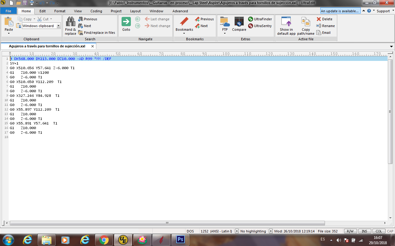

I'm doing my first tests with Aspire 8.5. I'm trying to CNC (morbidelli) a guitar fretboard (I'm attaching here a print of the .crv3d file).
I find the following problem: when I go to Save toolpaths, the drill toolpath appear (in the .xxl file generated, a print also attached here) as G orders (pocket toolpaths) not as B orders (drills).
Any idea about what is or what am I doing wrong?
