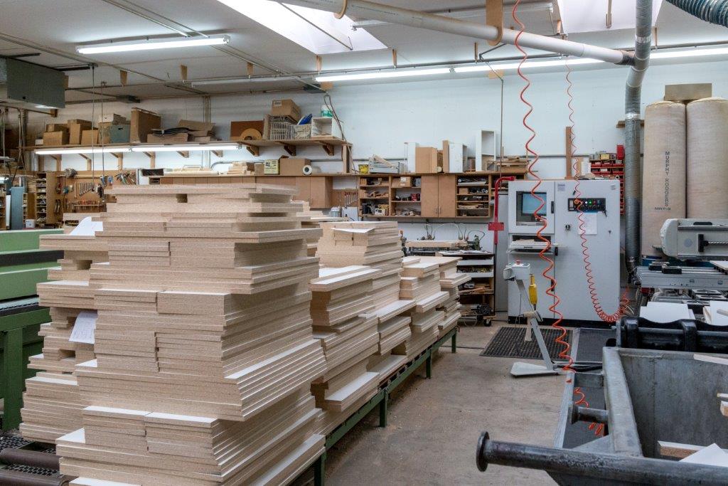

12/7/18       #3: Show me your parts carts ...
Bruce H
I stack mine on rollers with the parts list. These are waiting processing.
