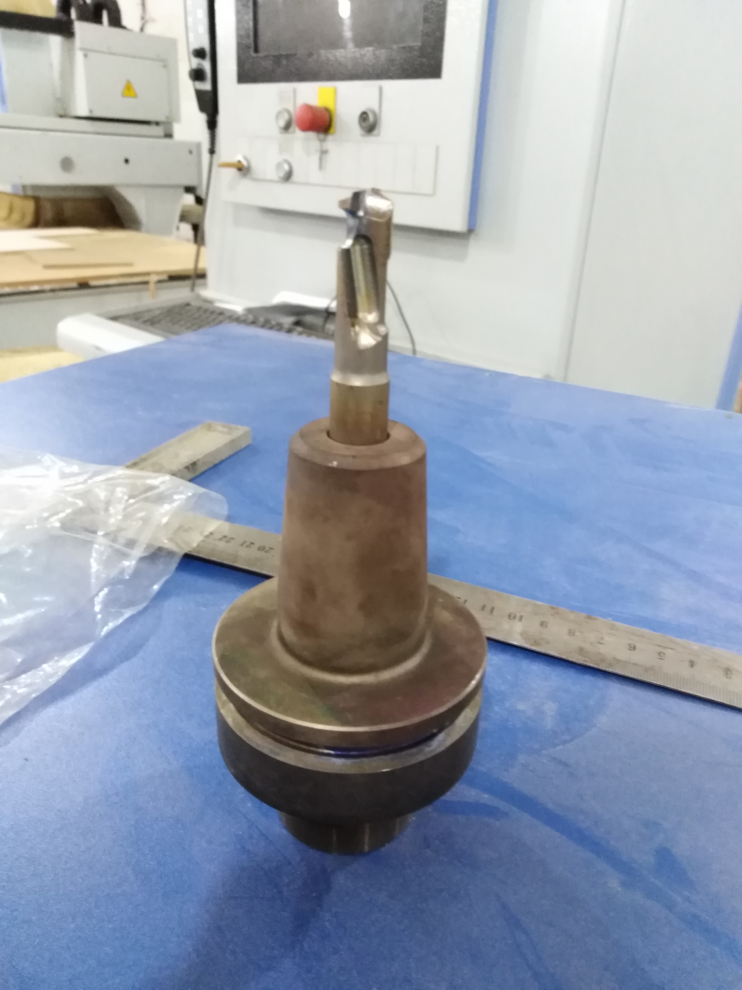

Hi all hope ur having a great day
This tool holder came with my used cnc
I send it and had installed a 1 flut pcd bit
Its my first bit of this kind
Any tips about using this bit
Thank you all

What do you want to know?
We use a lot of PCD bits for milling MDF.
Tool life with a good PCD bit for us is about 30 times longer than an equivalent carbide tool and the price is usually about 4 or 5 times higher.

Yess ur right its cost to much
And very slowww i am going 4 m/min 18000 rpm
Cutting chipboard and it seems that i am getting dust
12/13/18       #5: New cnc bit ...
Todd Zuercher Member
4m/min @18000rpm is much too slow for that bit.
You should be cutting at least double that, if not faster. In MDF we cut at about 6m/min @16000rpm single pass in 19mm MDF with a 13mm bit. And we were told by the tool manufacture that we are cutting at the slow end of acceptable chip load. (much faster though and we have too much trouble with parts moving.)

Like they said that is way too slow, going to burn that expensive bit up. i run 2flute compression one pass 19mm mdf @ 18m/min. try this chart to get halfway close then tweak from there. https://www.vortextool.com/pub/media/assets/chipLoadChart.pdf
quick rule of thumb: increase feed rate until cut quality deteriorates, then reduce rpm till cut quality deteriorates.

Thank you all for ur help
I am working now with 5.5 m/min 16000 rpm
Getting better chips but still dust

I also use these bits and was wondering what it sounds like for you guys? Mine always seem to have a high pitched squeal when cutting. I'm going to try 6m at 16K RPM today to see how that performs
1/14/19       #9: New cnc bit ...
A high pitched squeal is often indicative of a tool slipping in a collet (usually a bad collet).
