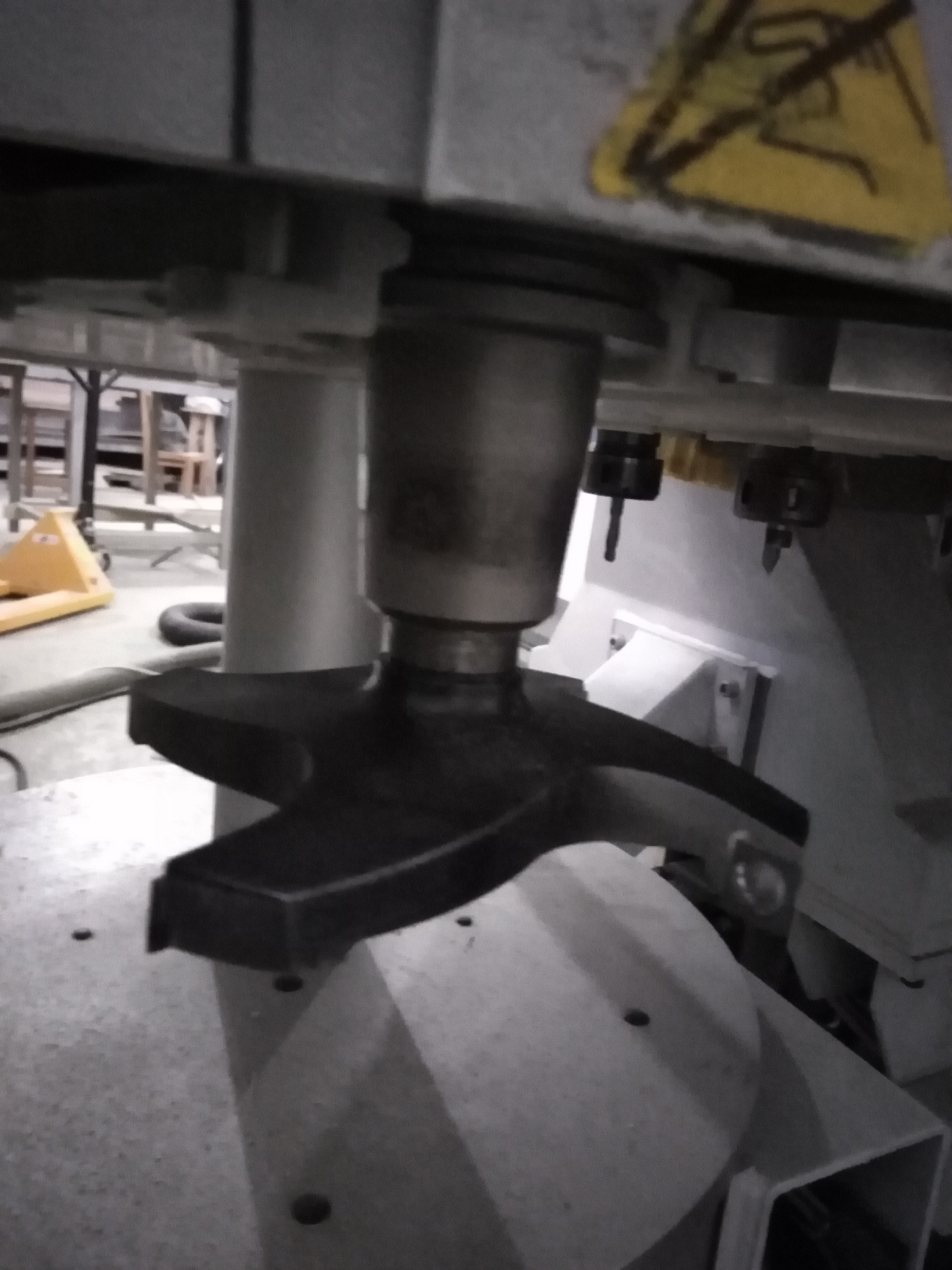

Anthony Member
Thank u all for this great tips this is the picture of my bit its a 10 cm bit
