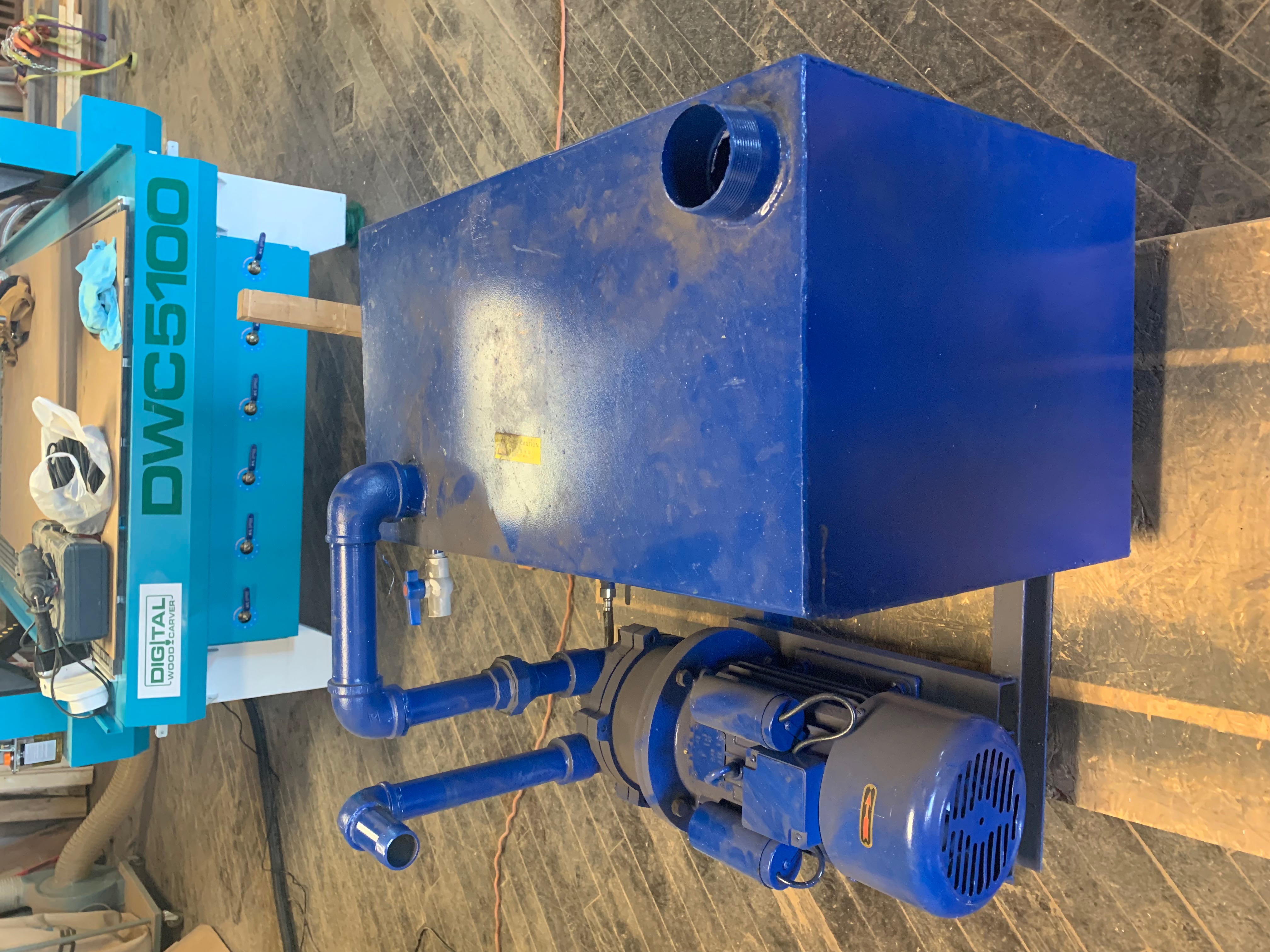

I am new here and just got a 4x8 CNC through Digital Wood Carver to replace our tiny Inventables one. Huge step up in the shop!
This vac pump fell in my lap but I don't know much about it. Info on the web is all over the place, especially when I'm thinking on a budget. What I do know is this pump came from a cheaper 4x8 CNC that the person had no intentions of ever using it so he doesn't care nor know anything about it.
What I want to know is:
what kind of pump/Vacuum is it...

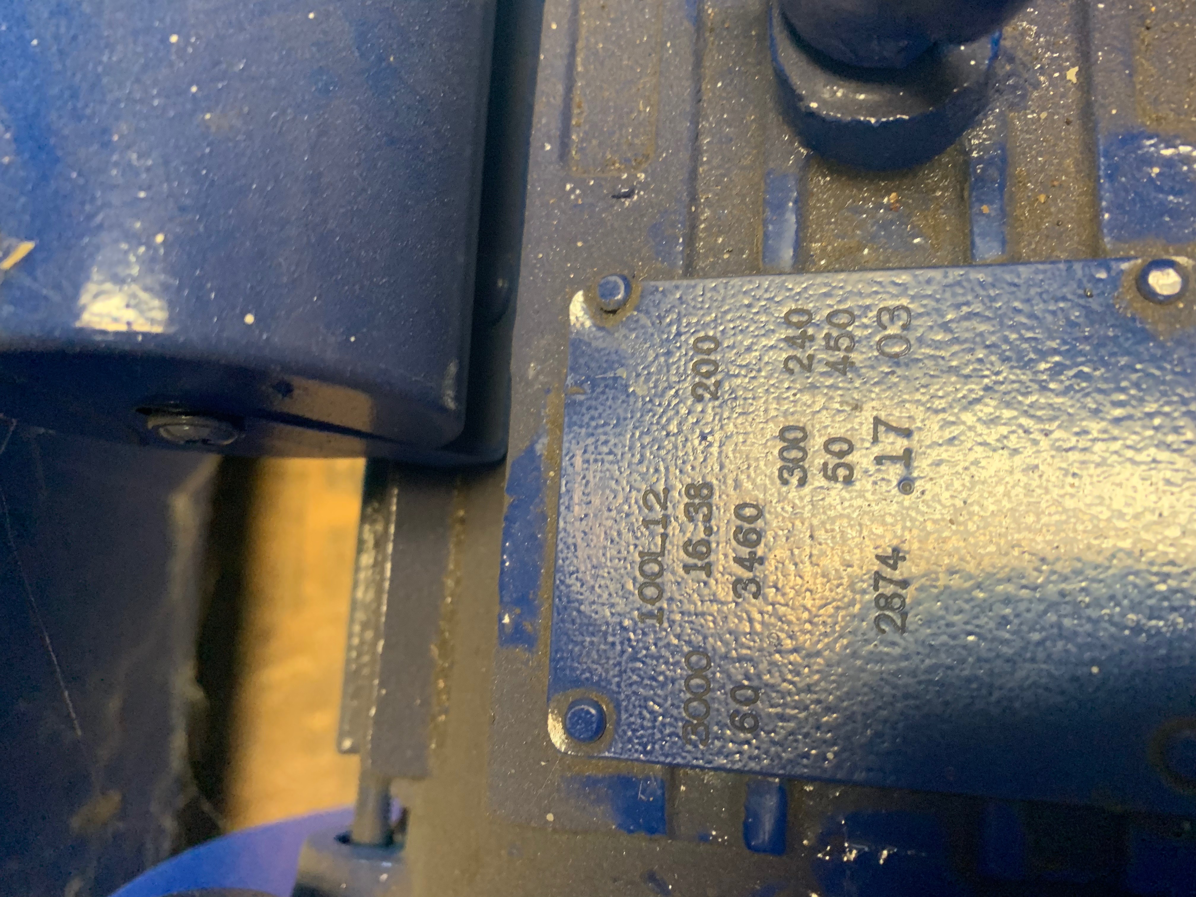

what do the numbers mean besides its a 220 volt...
What does the big box do...

This *looks* like a random chinese liquid ring vacuum pump.
The faceplate is hard to decode without more.
the 3460 is probably RPM, the 16.38 is probably max amperage.
Do you know how many hp the pump is supposed to be?
the 200 may be the m3/h, it would equate to about 120cfm. That would be high for a 5hp pump (which is what 16.38 amps at 230 3 phase would be).
It would work for a 380v pump at 7.5hp or a 460v pump at 10hp (which is what 16.38 amps would be at each of those voltages)
