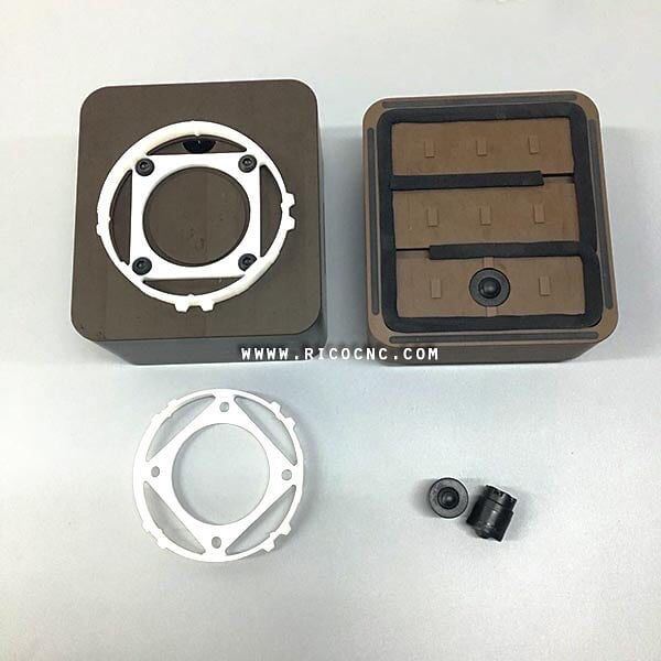

Sherry Zhao  Member
Website: http://www.cncsparetools.com
Biesse suction pods are mainly made of 4 parts, including base body, bottom white locating ring, black ball valve, and soft rubber seal. Usually, the base body is not easily damaged, but other parts are easy to wear and damaged. So if minor damages, you can try to replace these small parts. It is not hard.
