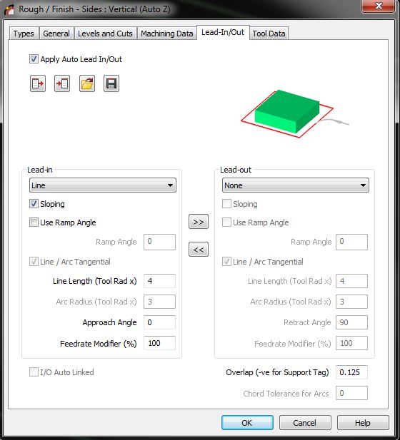

7/16/19       #6: More effective pocketing toolpath i ...
Eric
try going to your rough/finish lead in/out.
on the lead-in do a line, sloping I use line length tool rad x 4 approach angle 0. with your lead out choose none. works perfect.
View higher quality, full size image (560 X 617)

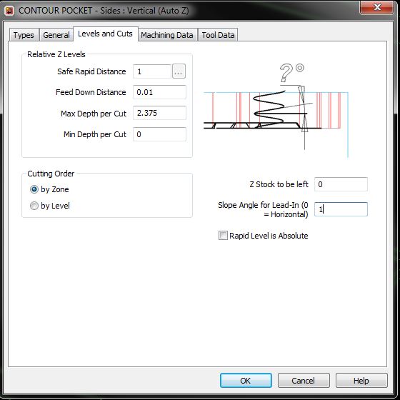

7/16/19       #7: More effective pocketing toolpath i ...
Eric
sorry about my last response. thought you were talking about a pocket screw.
when in your contour pocket under LEVELS AND CUTS change your slope angle for lead-in to 1. you may not need to go all the way down to 1 but it works for me with my 50mm fly cutter.
