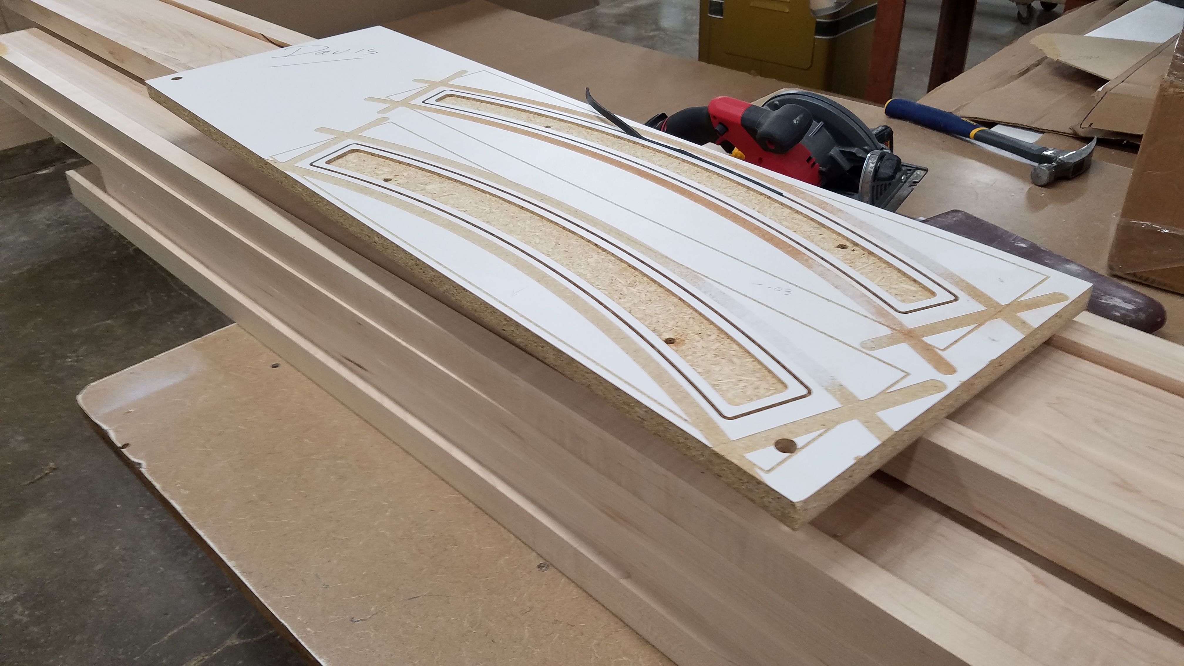

I have a flat table too. Matrix grid underneath. I make custom fixtures to hold solid wood parts. just offset the shape of the part to the inside, cut an 1/8" groove for 1/8" x 1/4" gasket. Inside of that geometry, cut a pocket 1/8" deep in your scrap melamine fixture for the vacuum area. inside this area is a thru hole or holes for vacuum to be pulled from the grid table. Part will stay in place. I'll attach a picture.

Yes.......another very good method. I'll only add that you refer to a "grid table" so I take it that running with a rotary vane or similar vac pump vs. a regenerative blower. As I mentioned that's what it would take for vac pods........or custom fixtures like yours......to work.
Please correct me if you are indeed pulling this off with a regenerative blower. I'd like to know the specifics.

Yes, rotary vane. These fixtures need very little vacuum. The gasket seals the part to the fixture. Don't know why it wouldn't work with a blower. If your blower works with pods, it will work with this type.

I run tons of Arrows of Light for scouts with the way Mike has the melamine cut except I usually screw in from the bottom.
I also have run 8/4 birch and maple that way too
