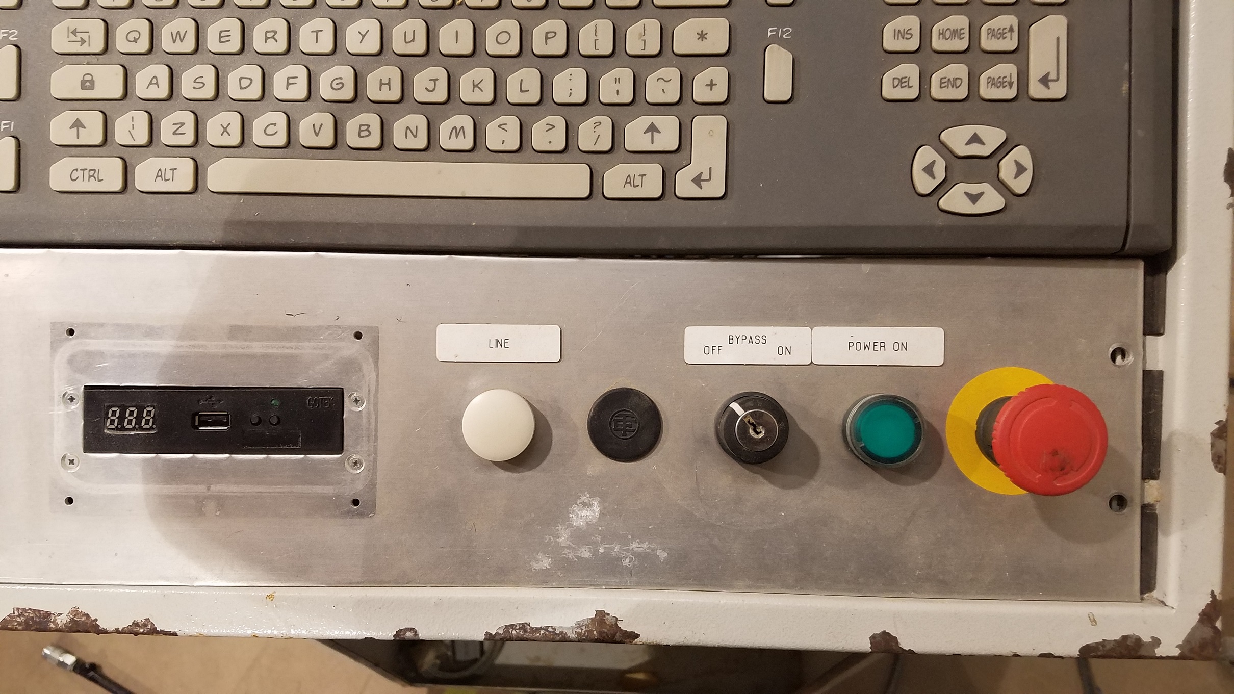

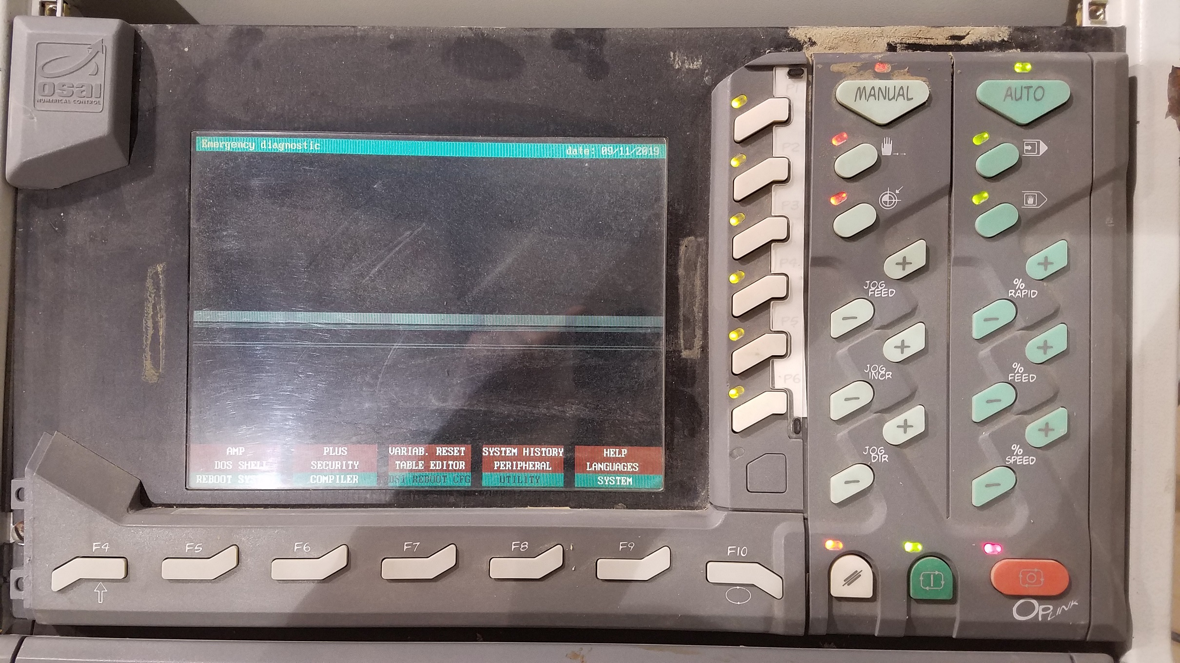

I got it wired it up etc. It powered up fine with no alarms that I can tell of. But, that is as far as I can get. I've run other CNC's but this is so old I'm a bit lost even with the manual. all the lights on the manual and auto side are lit up (SEE PICS) including the E stop, start and the hotdog in a bun icon button?. That doesn't seem right?
I'd like to come visit a user if you are in the south somewhere to see you operate yours first hand if possible? That would speak volumes! The "power on" button doesn't light up when pushed nor do I have a key for the "bypass" Not even sure what that does?

Looks like an old OSAI 10 control. You may need to hold the power on button for 60 seconds or so. On my machine (Biesse Arrow with a similar control) you need to hold the button until you hear a contactor inside the cabinet latch.
Even if you did see it running, if the CMOS battery is dead you will have lost all the info in memory and restore it.
The screen you show is not a normal startup screen.
