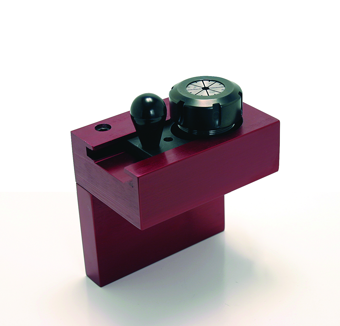

We can help with that also if needed. We mounted our stand on the vacuum pump frame to get away from the dust if you don't have a bench handy
View higher quality, full size image (1408 X 1349)

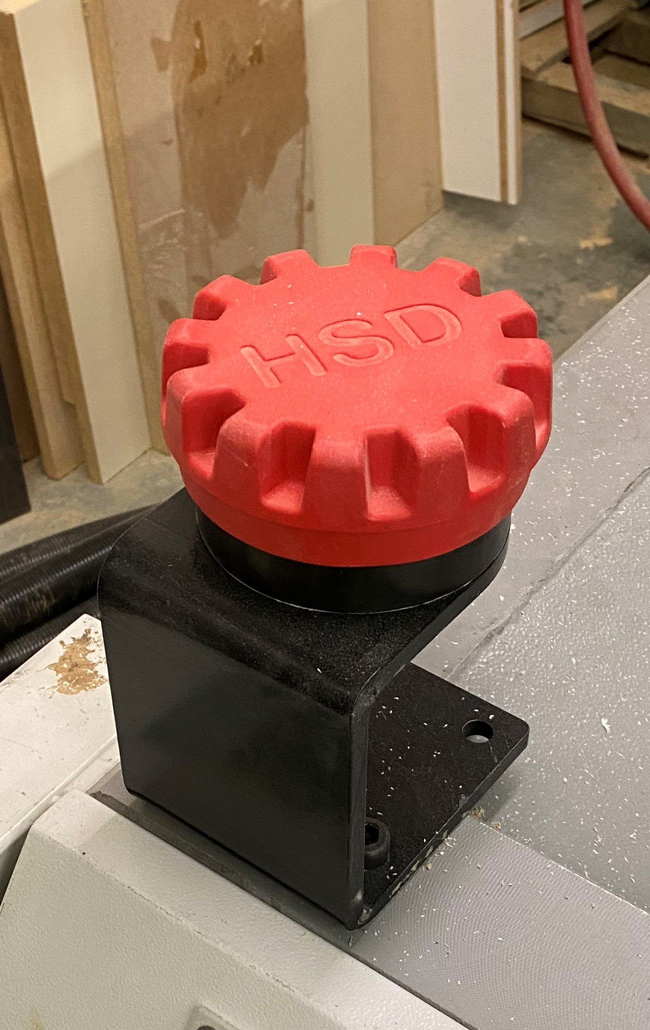

I mounted one of the roller type on my Rover about 9 years ago and it has worked fine for me ever since. I did put a dust cover on it, mine is a shipping cap from HSD rebuilt iso 30 spindle, fits over HSk 63 F roller stand perfectly.
View higher quality, full size image (1301 X 2061)
