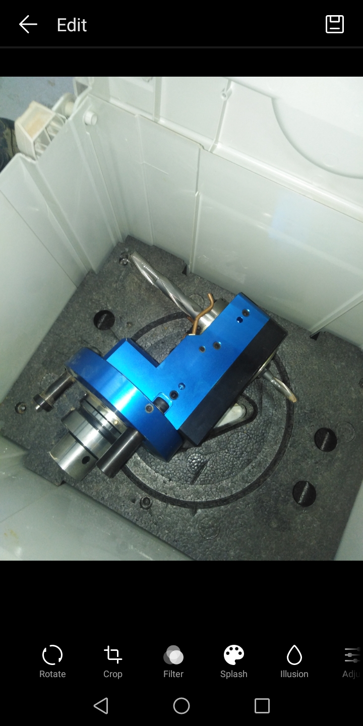

Hello all hope your having a good day
I start using this aggtegate does any one know if i shoould grease it? Or how to maintain it
Thank you
View higher quality, full size image (720 X 1440)
1/28/20       #2: Greasing aggregate ...
cabinetmaker
Not sure, but looks like a Benz product.
Kluber make good grease for your application.
Try to find a mfg and they can direct you
1/29/20       #3: Greasing aggregate ...
steve
It's a Benz, signature blue, looks like it's for a Homag/Weeke as well.
Sealed units, at least all 8 I've had are. They last forever though, again, my experience. Send them to Benz USA for reworking when they get loud or start getting a lot warmer than they used to.
1/29/20       #4: Greasing aggregate ...
We change the oil periodically on our oil bath types, but the grease type we dont do anything special. Just run them to proper specs and they will last a long time. As someone else mentioned, just keep an eye on the temperature.
