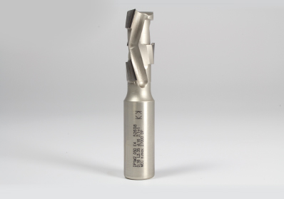

i cut with my cnc melamine sheets using a pcd dimond bit 1 flut and i need to run my cnc at 20000 rpm and 4 m/min
does it affect my cnc in any way ? i cut 3 4 hrs at a time

Why do you need to run those parameters? Is it to achieve the cut quality or because the boss says so? What machine do you have?
I run a mid weight machine at twice the feedrate with a spindle speed of 15000 with a two flute compression bit. Others with heavier machines can run twice that feed.
Are you harming your machine? It depends. Look for the signs of strain - hot stepper motors, poor cut quality especially at corners, skipped steps.
Without more details we can't help you much.

What are the specifications on your spindle. Seems like high rpm's for a slow feedrate. I run a 3 flute tool at 1000 inches per minute at 18000 rpm's penetrating 0.005" into the board. We run 10 hours per day without breaks, but not all of it is casework. We also cut a lot of solid hardwood up to 4.5" thick and a ton of solid surface. I usually only use pcd diamond tools on material such as Fundermax or other phenolic type material.

I have a weeke vantage 38l
I work with laminated chipboard to make cabinets i use a similar bit to the picture its a 1 flut bit
I dnt have much experience with choosing bits to cut my sheets so i have been advised by the bit dealer to use this bit with this rpm and speed
What fo u use for nesting sheets?
3/23/20       #6: Pcd Diamond Bits for Melamine quest ...
3/8 coated compression spirals from FS Tool. 3/4 melamine 750 to 900 IPM at 18,000 RPM.
