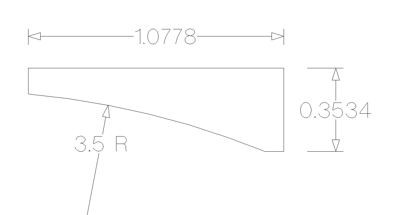

Before I pull the pin on a custom tool Im wondering if anything pops into anyones head or if any of you have seen a tool that would fit this profile even approximately.
We have a bunch of production parts to run and the prints call for a 3.5" radius eased edge but that radius is slightly flexible. I thought maybe I could track down a 1/2" or 3/4" shank panel raiser that had a portion of the profile that would work but Im coming up empty on a long round of searching and going through catalogs.
Its a bit of a crunch job so I'd love to find something off the shelf rather than waiting 2-3 weeks for a custom tool.
The width and depth on the drawing arent critical but a large rad roundover is not looking promising in any searching Ive done.
Thanks for any input.
View higher quality, full size image (1295 X 696)

The stepped option would be too slow for these parts with run time and then subsequent cleanup and they are small and round (various sizes from 4"dia. to 6.5" dia).
We are wanting to run them in a single roughing pass and a light finish pass. These need to be on and off the machine in seconds and basically zero cleanup.

Depending on where you are located, I would think it should not be difficult to find a local (or semi local) company to make a knife for a molder or a shaper cutter. We have two local saw and tool companies within 50 miles of us that would make these knives within 2 days.

Try Total Tooling Technology 847 437 5135 ask for James. Your on the right track of having a standard cutter reground to the profile.. They are good a quick turn items

Thanks for the contact HenBob, great quick convo, order in first thing a.m., much appreciated.
