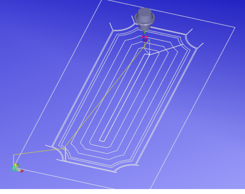

this sample from our software
the geometry calculate is ,you make offset out to yours base shape(the amount is depened tool angel)
then conect the corner points from base to offset
hope its clear
yaakov
