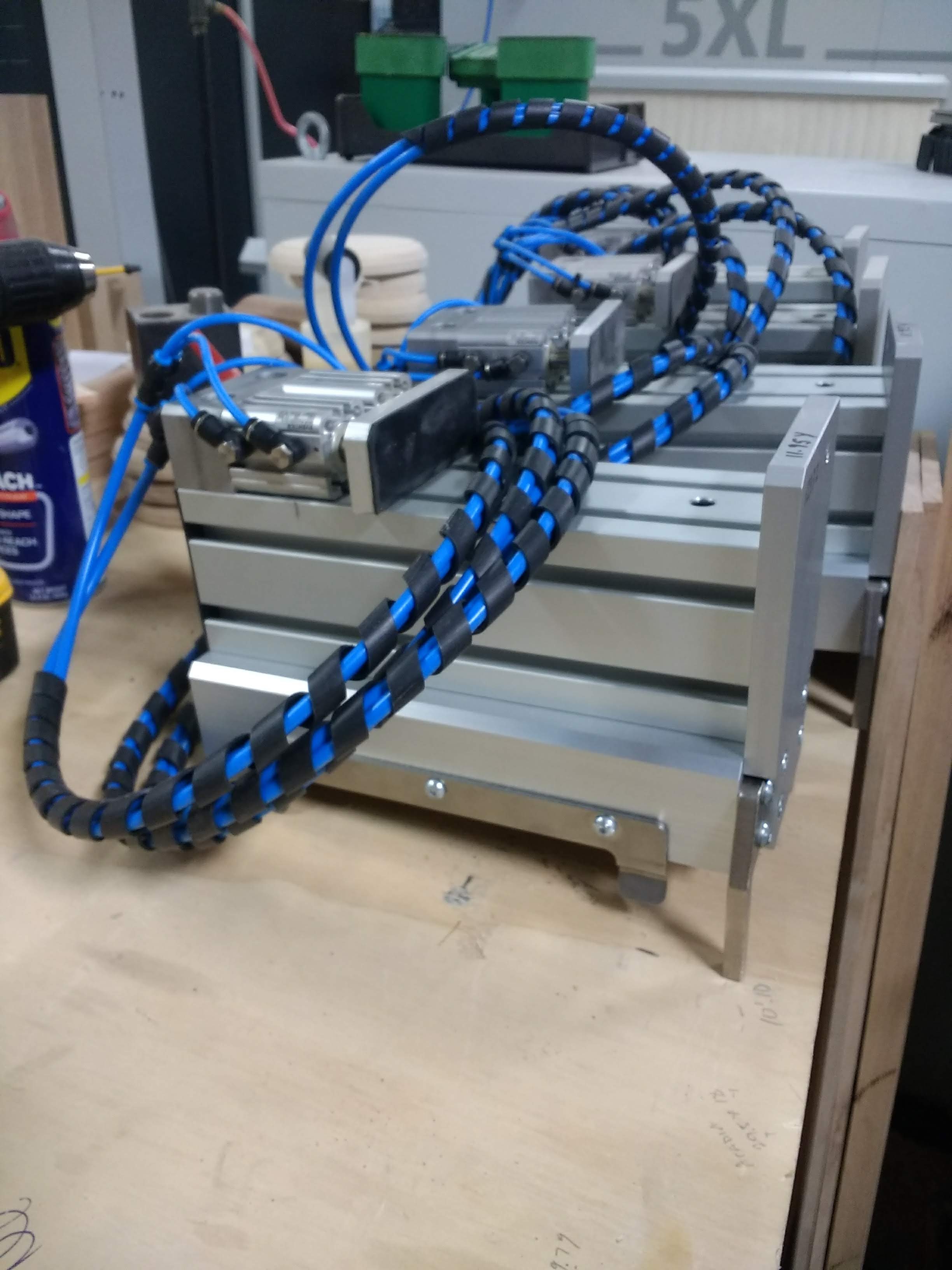

6/26/20       #6: Vises ...
Ian
Here's a picture, wasn't sure if I had one. Pretty sure they're Holzher WS- 6 if I remember right
6/26/20       #7: Vises ...
Thanks.
Just what I was looking for.
