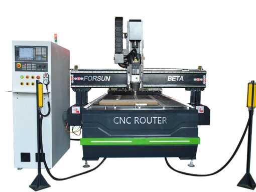

FORSUNCNC Member
Website: http://forsuncnc.com/
This CNC router machine is suitable for foam mold manufacturing, cabinet manufacturing, plastic film processing and sign making, aluminum cutting and other mass production.
View higher quality, full size image (510 X 383)
New Automatic Tool Change Wood CNC Route
