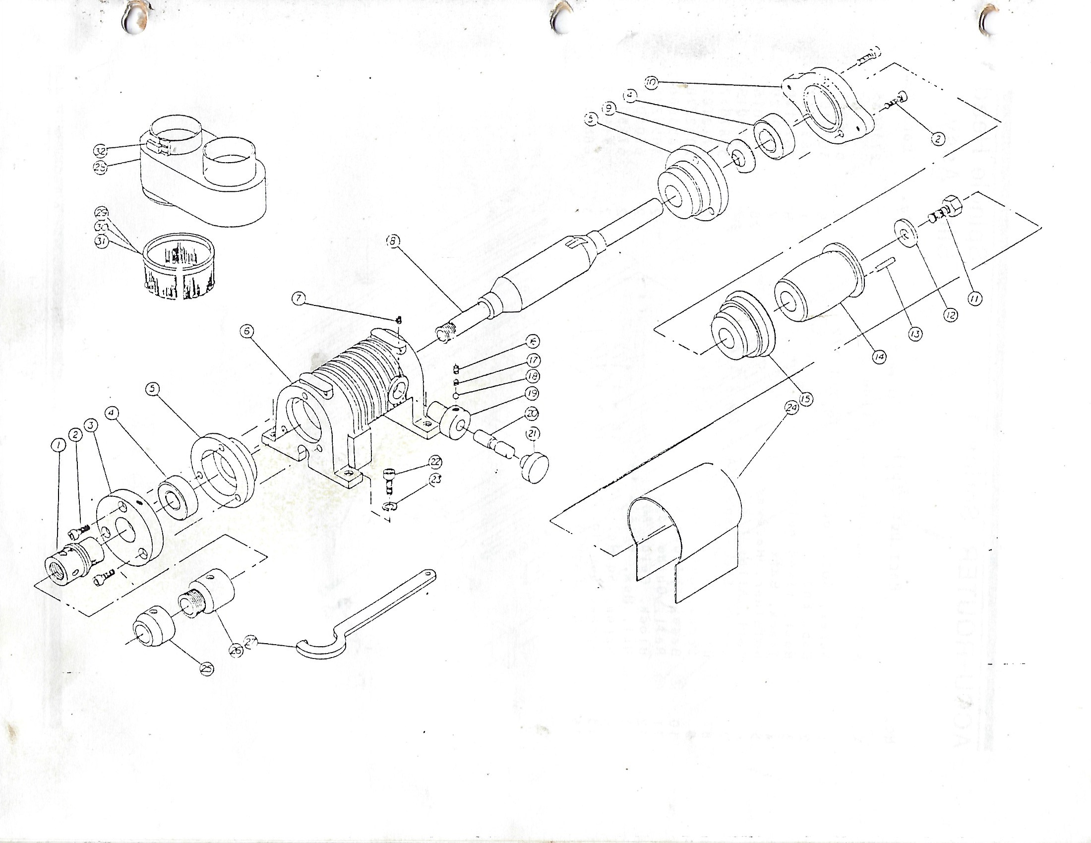

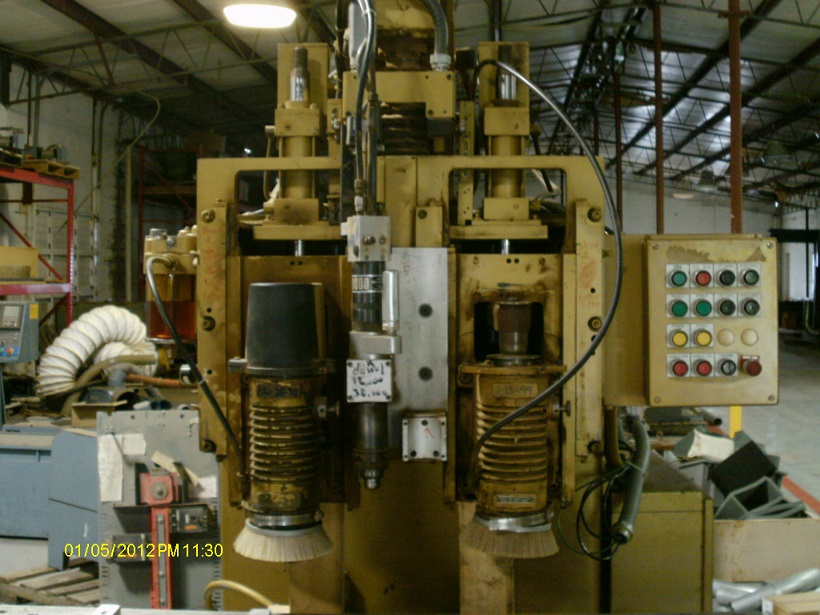

I have a 1987 cnc router featuring a "high speed", cast-iron spindle. Spindle is driven by a flat belt and powered by a TEFC Baldor motor. Baldor motor has a 10" long x 9" diameter aluminum "drum" pulley. Baldor motor is two-speed. Low runs fine. High has excessive vibration.
This is OLD school stuff. I actually have two routers and each has two spindles. The machines are old, but perform well, except for high-speed vibration. I just had my local "expert" motor shop rebuild and re-balance the motors and pulleys. Result: No better than what I had going-in.
Who has successfully refurbished this type of drive? What did you do? How long did it last? My machines are Powermatic Model 47, Accu-Router Series I.
View higher quality, full size image (2200 X 1700)
View higher quality, full size image (820 X 615)

Maybe it's the belts or spindles.
Try running the motors unattached to make sure they are (or not) the cause of vibration.

I thought I had the last of these. Mine is a Porter Router it has the same spindle. check to be sure the belt is clean without damage that there is nothing fouling the small pulley and that the collet assembly is balanced. Sometimes the top pulley can wear unevenly. Do run the drive motor without the belt to see if that might be the cause, if it runs smoothly you need to look at the spindle or try replacing the belt . Do not expect these to run as quietly as a modern high quality water cooled spindle.
