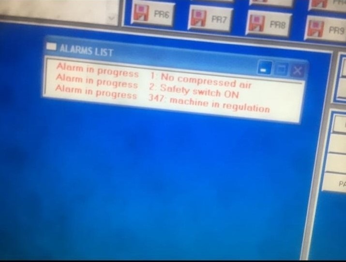

Any body help please
how to fix this problem of egde bonding machine.akron 850 biesse.
safety switch on
347 machine in regulation

The first thing you will need to correct is the air pressure alarm. On many machines the air pressure switch is part of the emergency circuit and will signal the faulty safety circuit. Check to make sure you have adequate air pressure on your regulator. If you do have enough air pressure, you will need to replace the air pressure switch.

Many thanks for reply dear Rob Young
dear rob young Now i have connected air pressure with machine .alarm of air pressure now gone but 2. safety switch alarm still have .can you guide me how to solve this problem.thanks for your value-able reply

Doors have to be down The safety switch needs to be at the lock position
Post a picture of the entire controller

The regulation switch is what allows you to be able to open your doors.
There is a keyed switch next to the green 24volt button. Once the doors are closed, turn the switch...that should turn off the regulation mode. There is a yellow light (above the computer monitor) that illuminates when in regulation.
