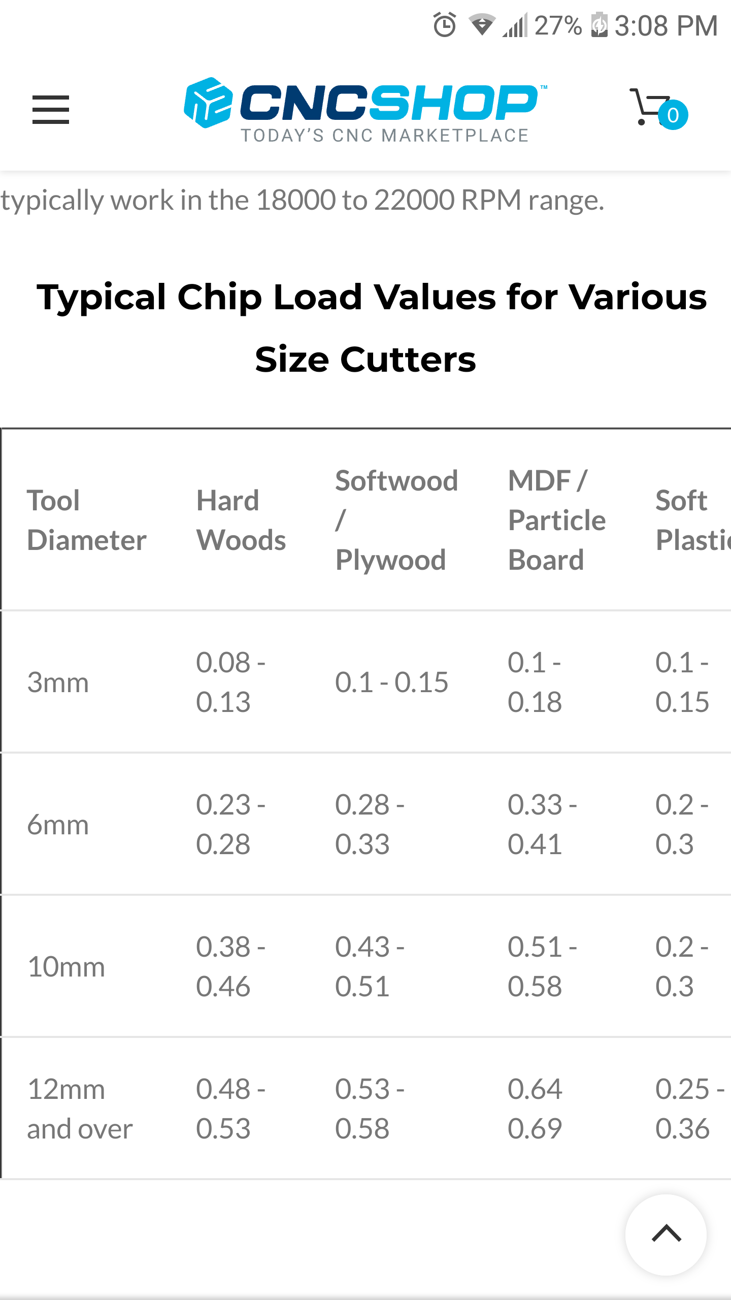

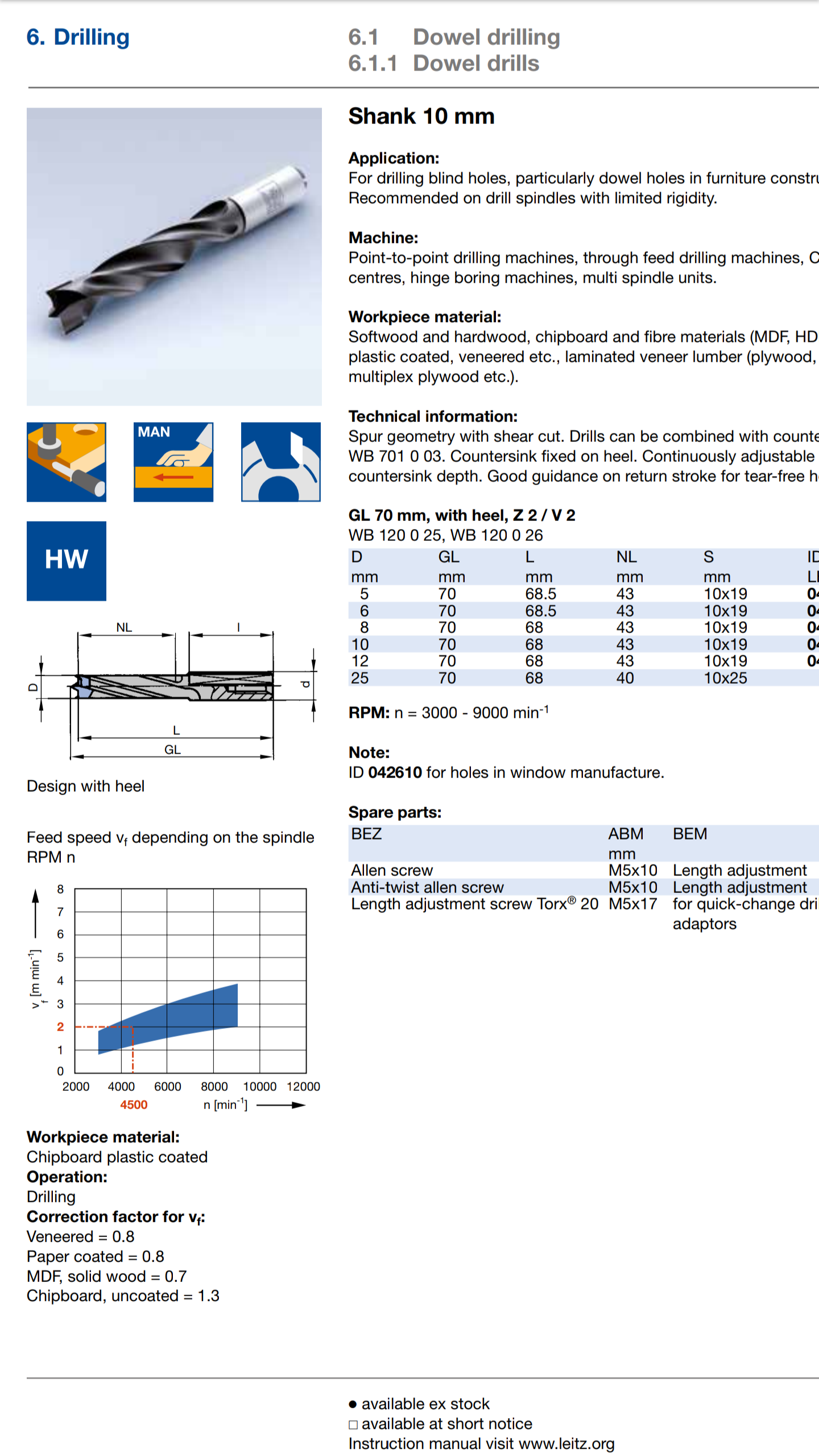

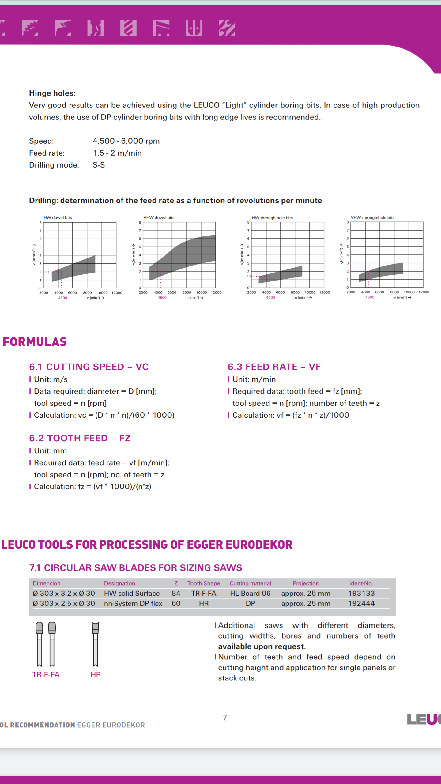

PLEASE SUGGEST FEED AND SPEED FOR
18 MM EGGER CHIPBOARD BORING / ROUTING.
I USE HOMAG BHX 200 OPTIMAT.
ROUTING - RPM 18000 - DEPTH OF CUT 9MM
PLEASE SUGGEST FEED FOR 6 MM , 8MM , 10MM , 12MM DIA SPIRAL CARBIDE BIT.
DRILLING - RPM 6000 -
PLEASE SUGGEST 5MM , 8MM , 10MM , 15MM , 20MM , 35MM DIA BORING BIT FEED.
FOR VERTICAL AND HORIZONTAL BORING CAN I USE SAME FEED .
PLEASE SUGGEST. THANK YOU

Seems from the attachments that you have all the info you need.
