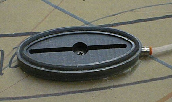

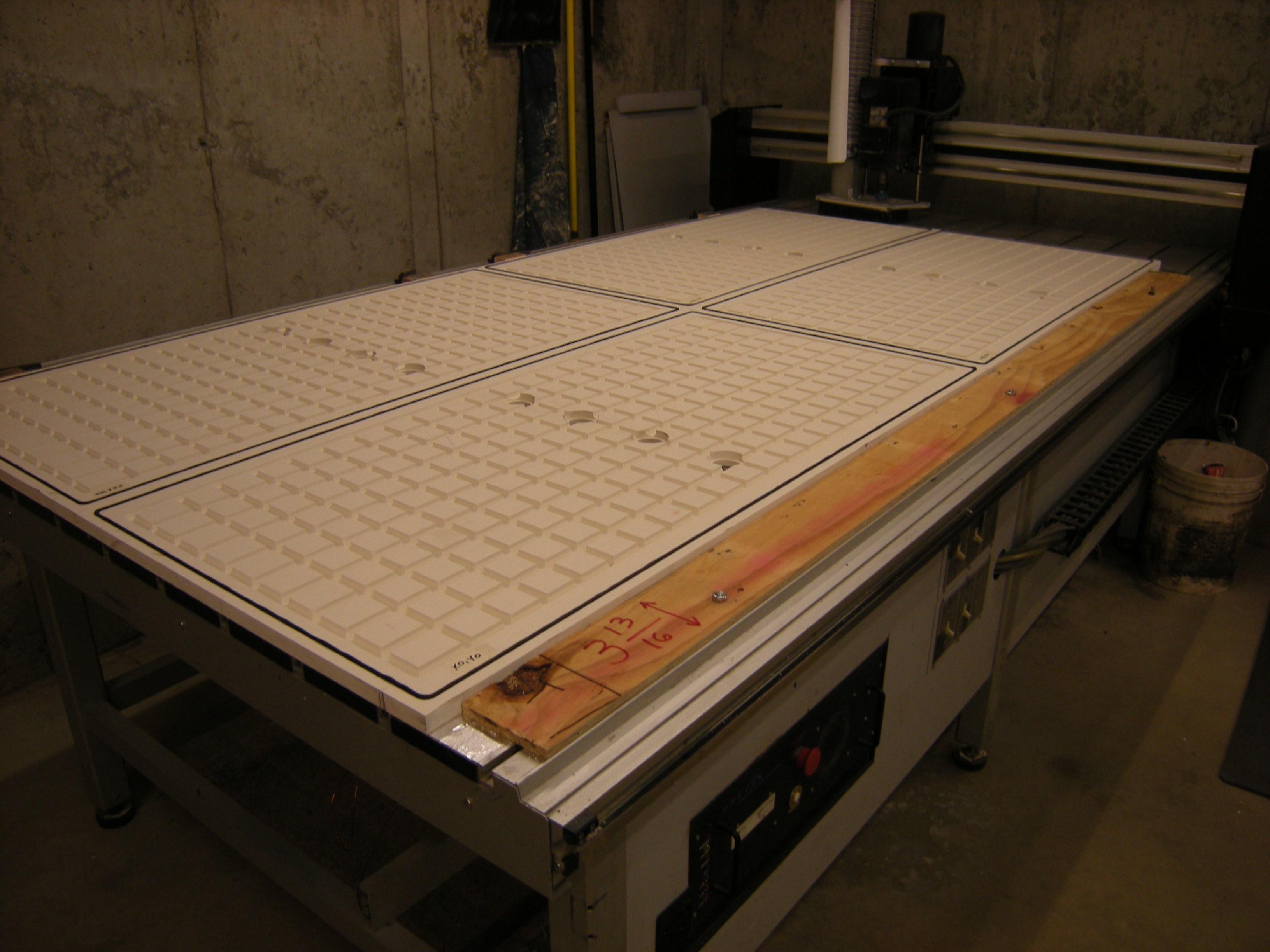

Gray industrial PVC from McMaster-Carr or plain old white Azek or similar PVC. If for permanent use I'd probably go with the industrial stuff as it is much denser and ding resistant. For one offs I'd probably use scraps of 3/4" PVC sheet stock........Azek or any other brand. Done it both ways and both work.
Here is a photo of my home retirement CNC hold down system with a 3/4" PVC hold down grid as I was just finishing it up.

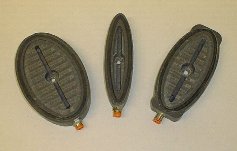

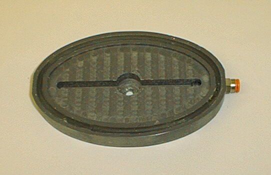

It took me a while to find these old photos.
These are the heavy density gray industrial PVC pods that I made back in about 2000. They are still in use in the business today. I must have made about a dozen of each size and 20+ years later they still work. A bit nicked up with some epoxy fill repairs but still functioning as intended.
View higher quality, full size image (786 X 502)
View higher quality, full size image (581 X 346)
View higher quality, full size image (542 X 350)

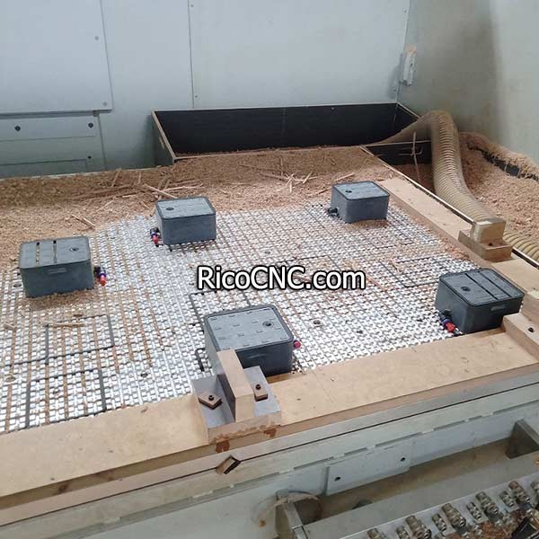

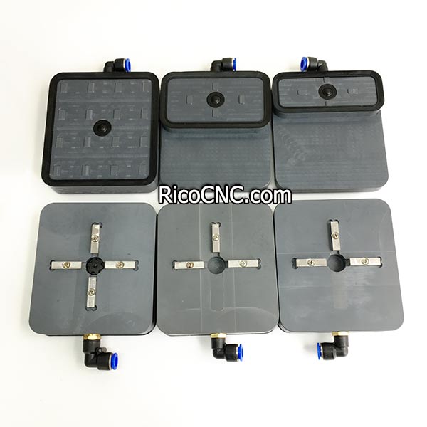

Hard PVC or bakelite are suitable material to make the vacuum pods. The CNC vacuum pods for Biesse Rover CNC are use this kind of material.
https://www.ricocnc.com/products/155-Flat-Grid-Table-Vacuum-Cups-for-Woodworking-Matrix-Table-CNC-Routers.html
