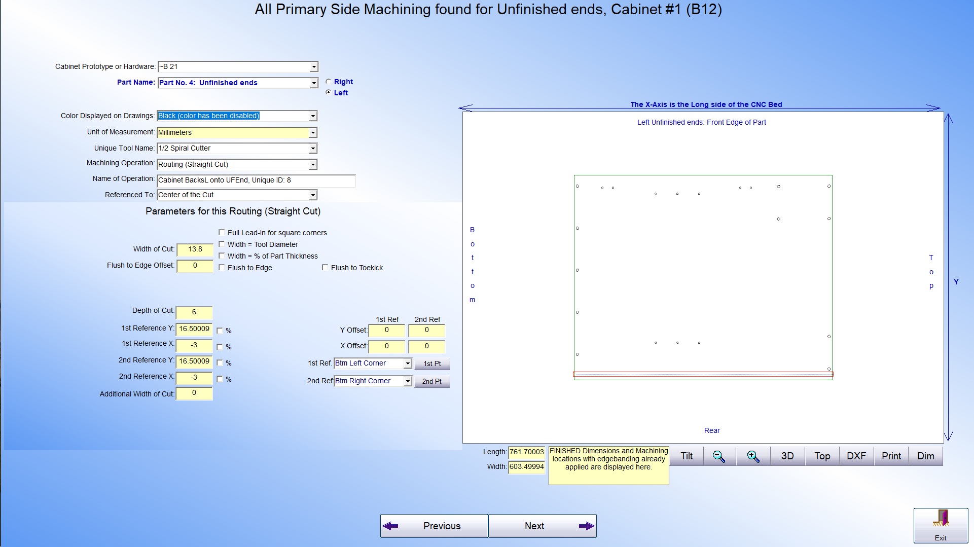

Cabinet Pro software has a working post for your Morbidelli N100. I've copied the code for that post below so that you may give it to Mozaik to perhaps speed up their creation of your post processor. The code that follows will drill holes of different diameters and cut out the part shown in the picture below. Both the picture and the code were processed in Cabinet Pro software, but Mozaik is welcome to use the code as a template if it will get you your post quicker. The tool number is easily defined as "T=102" and then "T=103" for routing, as you can see near the bottom of the code. (The Spindle Speed is defined there as well.)
Morbidelli Code that will machine the part shown in the picture below:
