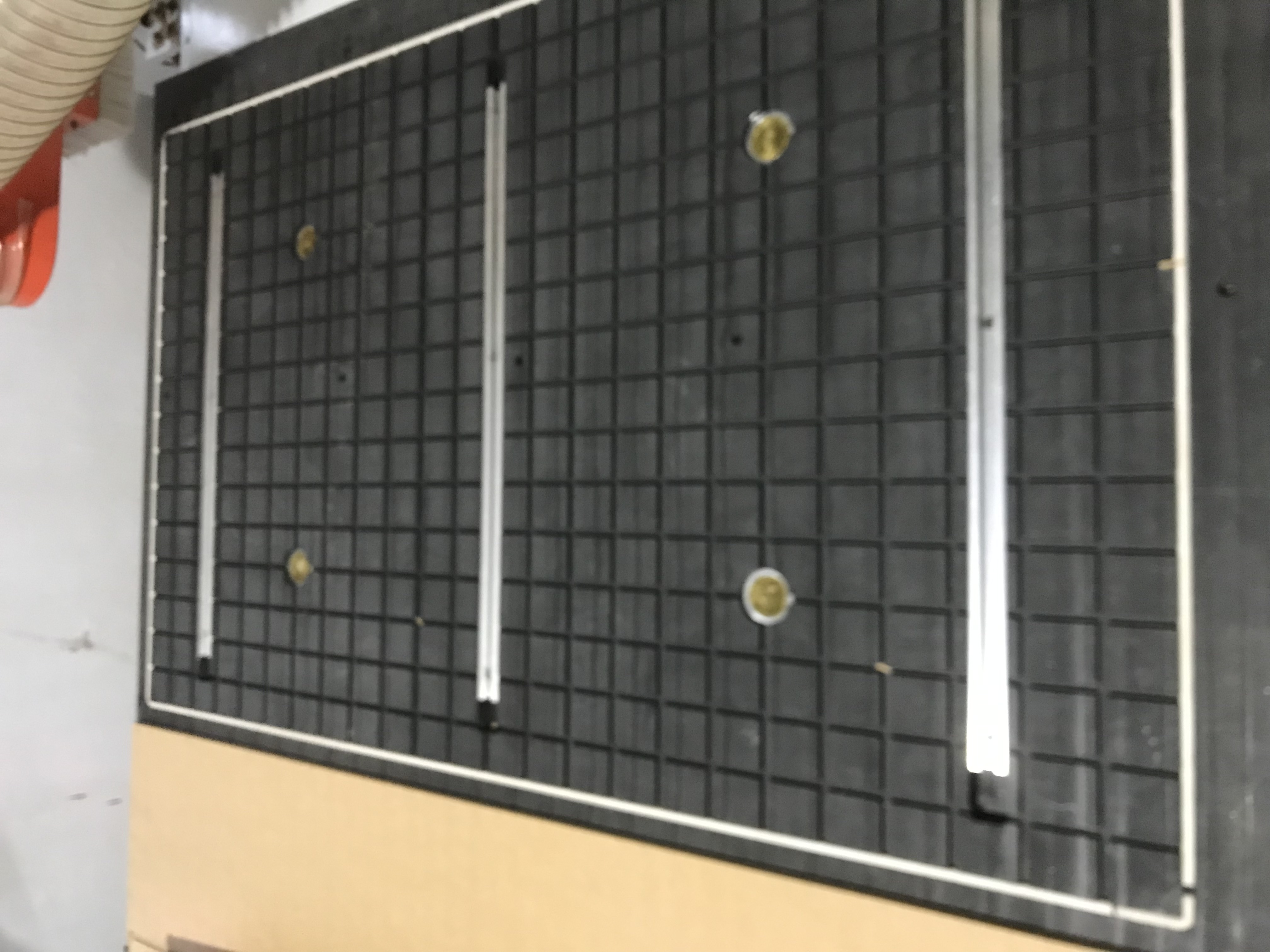

Hi, I have a 8 by 4 Chinese nesting machine with a pvc table with t slots, 6 vacuum inlets and a machined grid for gasket seal. i ve been told to glue the spoilboard on top of the table but I don’t feel confortable with a glued solution, reading the forum and in some videos I see solutions that screw the spoilboard using nylon screws and it seems to me a more flexible option. my table does not have threaded inserts for this so I’m wondering if I should try to drill and tap them or use the t tracks instead. Also not sure how to locate the t tracks precisely in order to drill the spoilboard. I read about edge finders used in metal milling should I use something like that? Many thanks!!

Forgot to mention that right now I am using the spoilboard with just the vacuum suction which works ok but I’m getting inconsistent results when trying to improve precision when milling pockets, my hunch is that the spoilboard warps slightly in some positions of the working area causing a non square cut most noticeable in pockets and slot based assemblies.

if you have a machined grid for gaskets, you shouldn't need any fasteners. When initially placing the spoilboard, you should machine both faces. Check to see if any of the gasket has not rolled out of position when sliding the board onto the table.

Can you post a photo of your table?

Thanks for all your responses!! It seems a complex topic with many variables. I believe my table is plastic, probably phenolic and not pvc as I said on my first post, picture attached. My vacuum is a becker pump just 5hp, I know is low but based on my electric setup I cant go for a higher pump so I need to make the most of this using various strategies -for fulll nested sheets with large carcass pieces works well with a good tolerance- for smaller pieces with mortises and tenons joints I am trying to get better accuracy on pockets.
My hunch is that the spoilboard does not lies perfectly flat because pockets tend to be slighty smaller than the program -something between 0.01-0.02 inches smaller than the program- and it is not consistent across the table surface so it shouldnt be a misalignment of the spindle-
Right now I have gasket around three areas such in the picture and the spoilboard feels pretty fix once the vacuum pum is working. CNC manufacturer told me to glue the spoilboard to the table to get a perfect flat and perpendicular base once is surfaced but I am reluctant to glue it, I heard that some people get good results by screwing the spoilboard using nylon screws, I would rather go for something like this if will increase my pockets accuracy.
