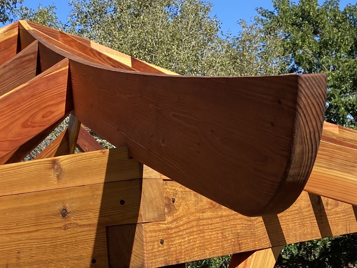

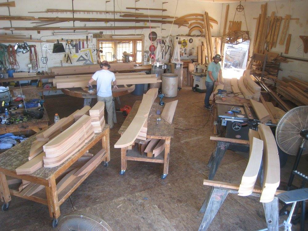

Folks, could you help me design a CNC setup for cutting these various curved rafters only? The CNC shop I usually take these to has been so busy the last few years that it sometimes takes weeks to get them back.
The widest pieces I'm cutting is 2x12, the longest would be 12' so I’m thinking a 2’ wide x 12’ long table. Could the router travel up and down a single strongback above the table? I only work with clear wr cedar and Calif. redwood ~ 2” thick so don’t need a powerful motor. I'm hoping to just set the CNC table on one of my shop benches when I need to use it.
How do I get started with this design? Are there any good resources I could check out? I'm in the San Diego area if that matters.

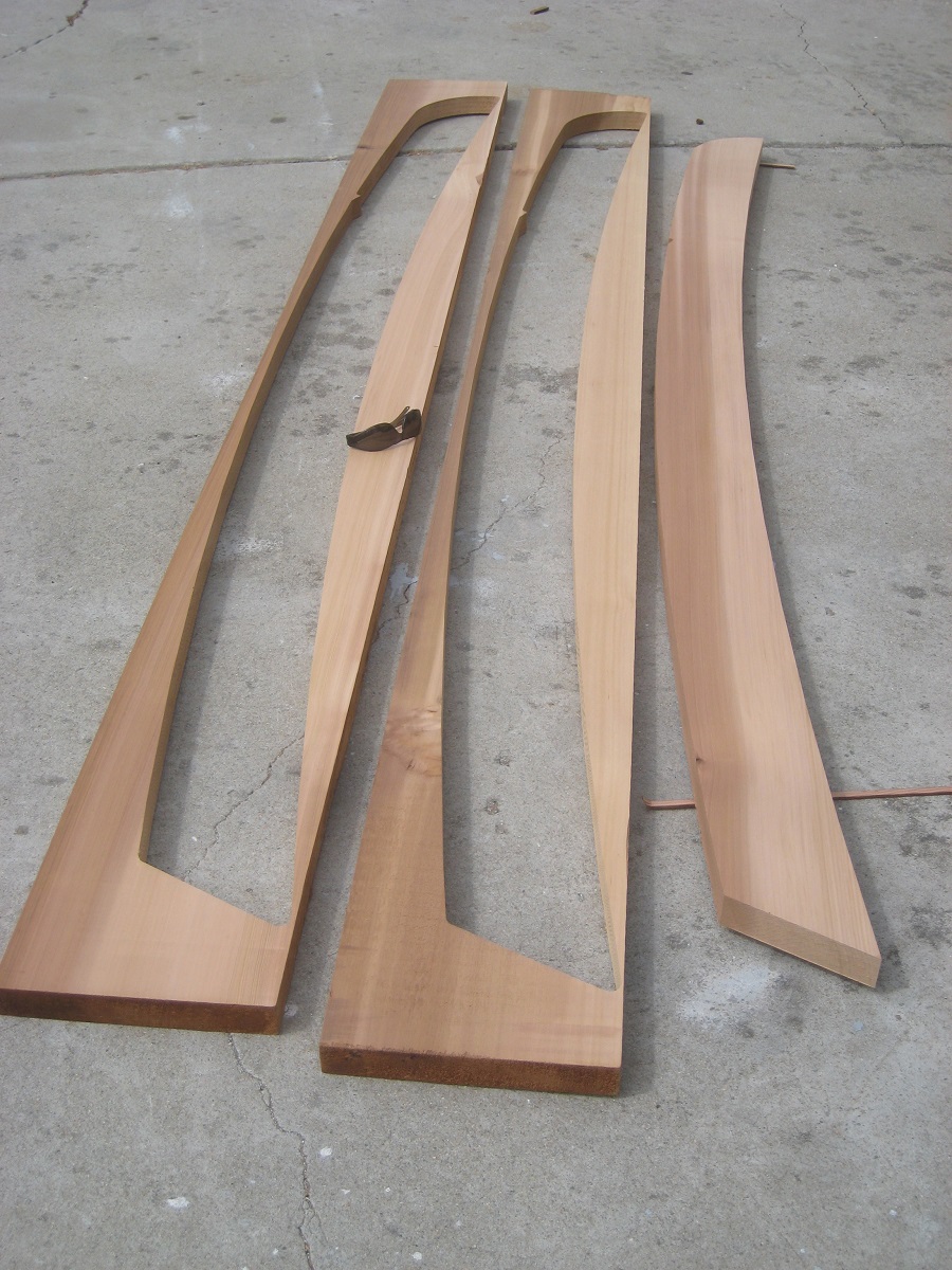

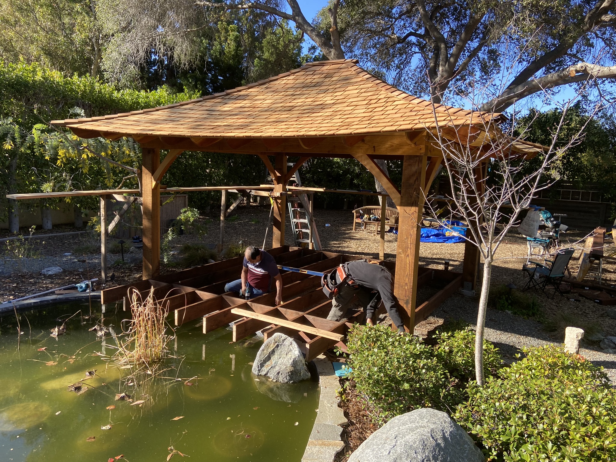

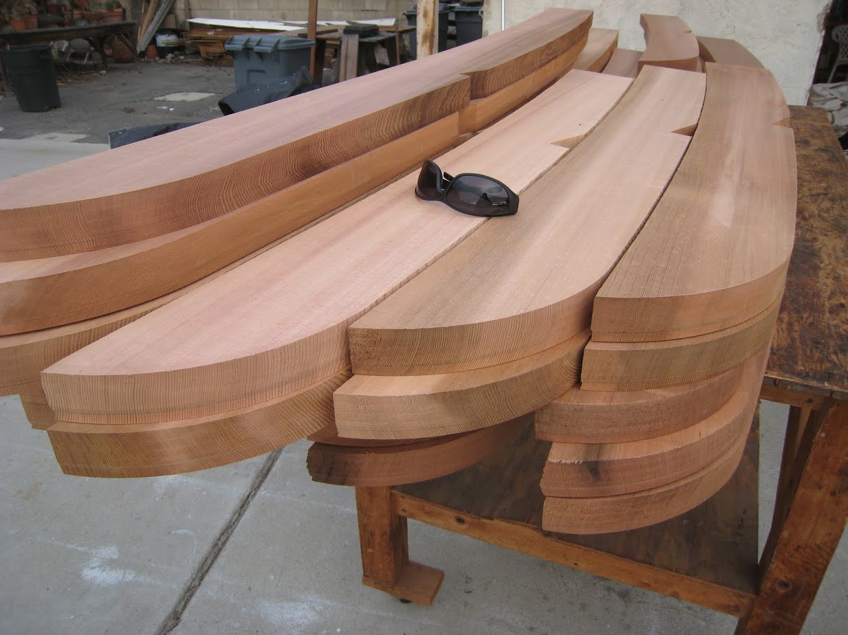

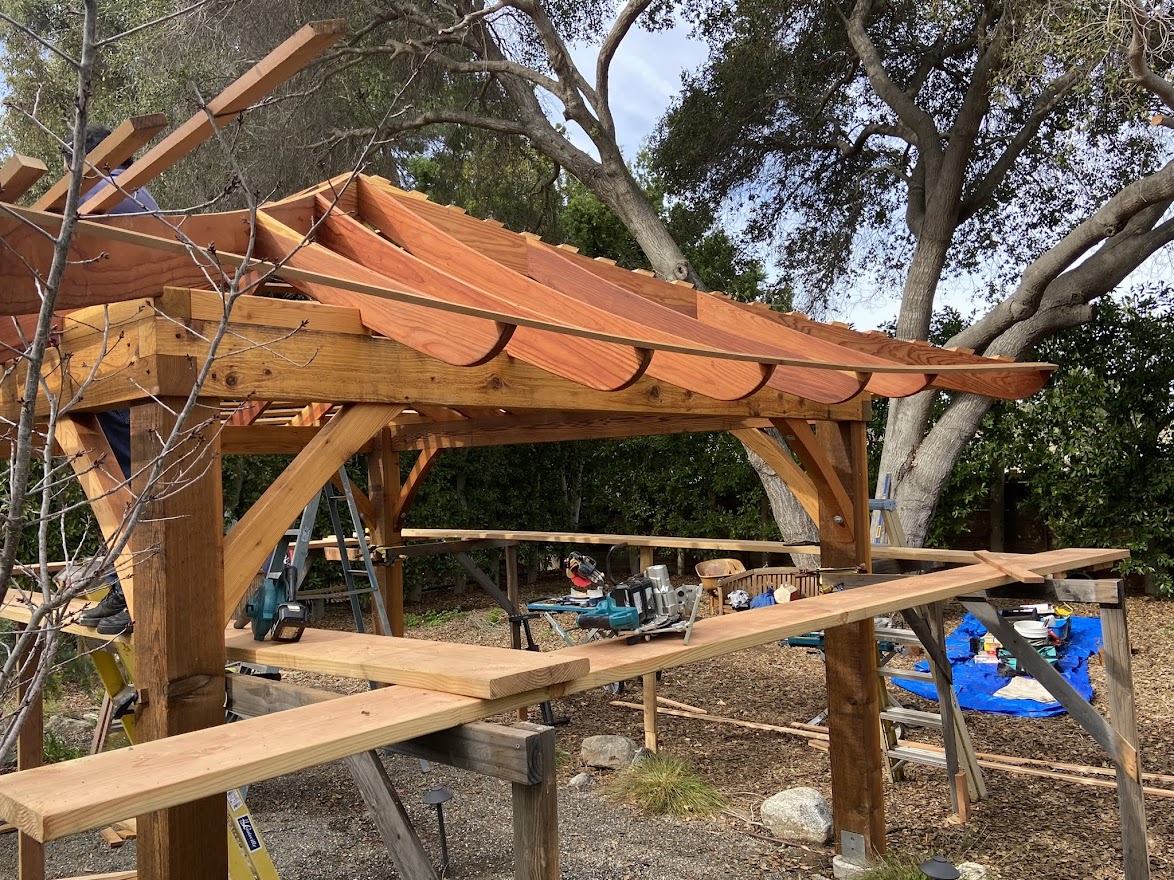

Some more images of the structures I need the CNC work for.

What you propose will not work. The quality of a cut is directly related to the rigidity of the cnc. Sure you could chop and extend a table top cnc with a 2' wide gantry but you will trash thousands of dollars of cedar trying to get a halfway decent cut that will take hours of run time and hours of hand work to clean up. If shop space is an issue then finding another cnc shop is your best bet.
Cedar and redwood may be soft and light but routing them can be tricky. You can pull large slivers off the workpiece if the parameters are wrong or the work isn't held firmly. The shop doing your pieces is doing very clean work. Can you negotiate with them to be more timely?
I cut a lot of solid on my cnc. It is not straight forward to do compared to sheet goods. I cut 11' components on my 4x8 router by flipping them in jigs so you are not restricted to looking for 12' machine beds. But I would advise you look for a mid weight machine at a minimum. Camaster, Shop Sabre, FMT etc.

Yeah each rafter has a diff shape depending on where it sits under the compound curved roof plane, the shop uses a 3/4 roughing bit in a few passes and gets a very clean job for the most part. He was often screwing the pieces down and we'd just fill the holes.
I can't get that vg cedar anymore so use the redwood which is very stable stuff to cut.
my idea seems very doable we'll come up with a nice design!

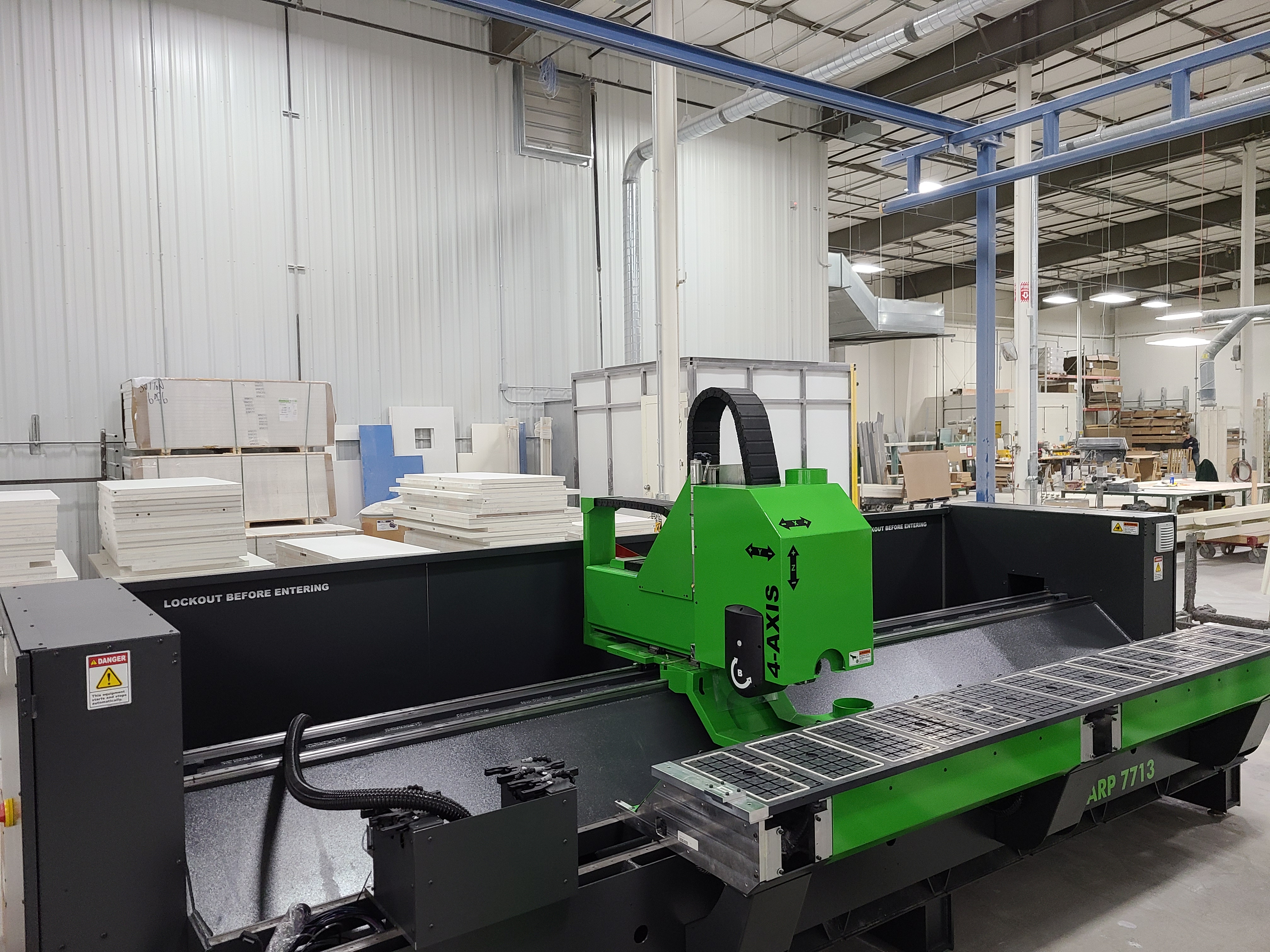

We've got you covered. The machine pictured has a work envelope of 16" x 156" (other sizes available) with several options for Z axis panel passage. Three, four or five axis spindles and many options for automatic tool changers, drill heads and secondary router spindles.
