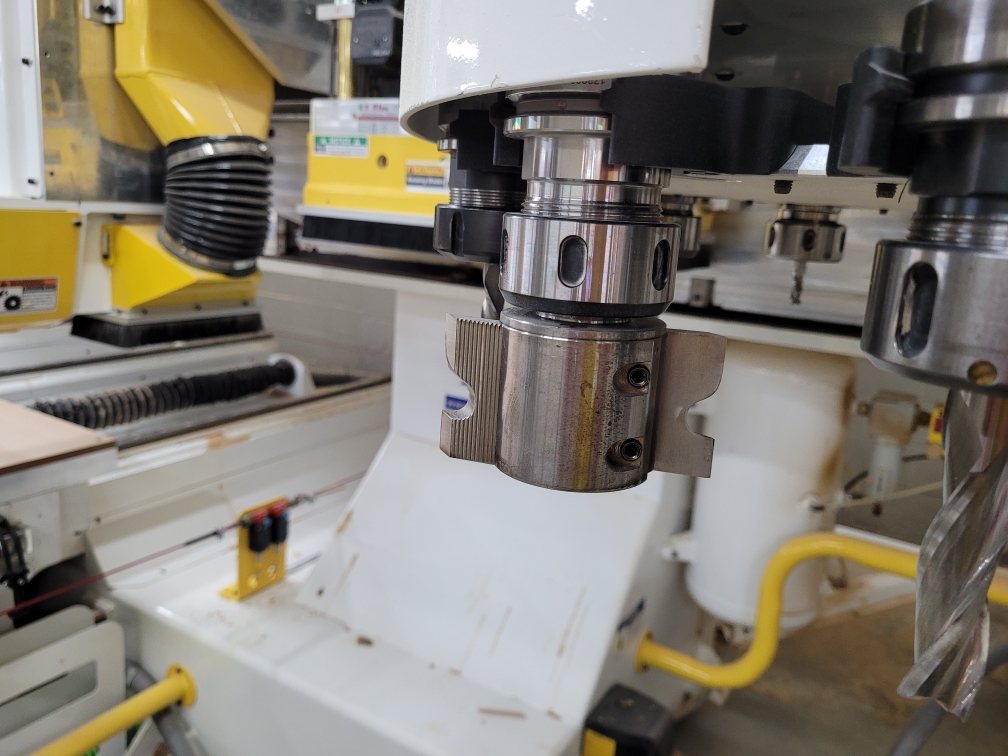

Are you looking for a shaper cutter head that will hold your own corrugated knife steel? I have cuts many profiles on hardwood using these knife holders. Mine have a 3/4" shank and have been worth their weight in gold over the years. I will post a picture of the body. It will also accept steel longer than the body. Sometimes it takes two of these cutters if the moulding is that large. I could provide an example if you are interested in the holder.
View higher quality, full size image (1008 X 756)
