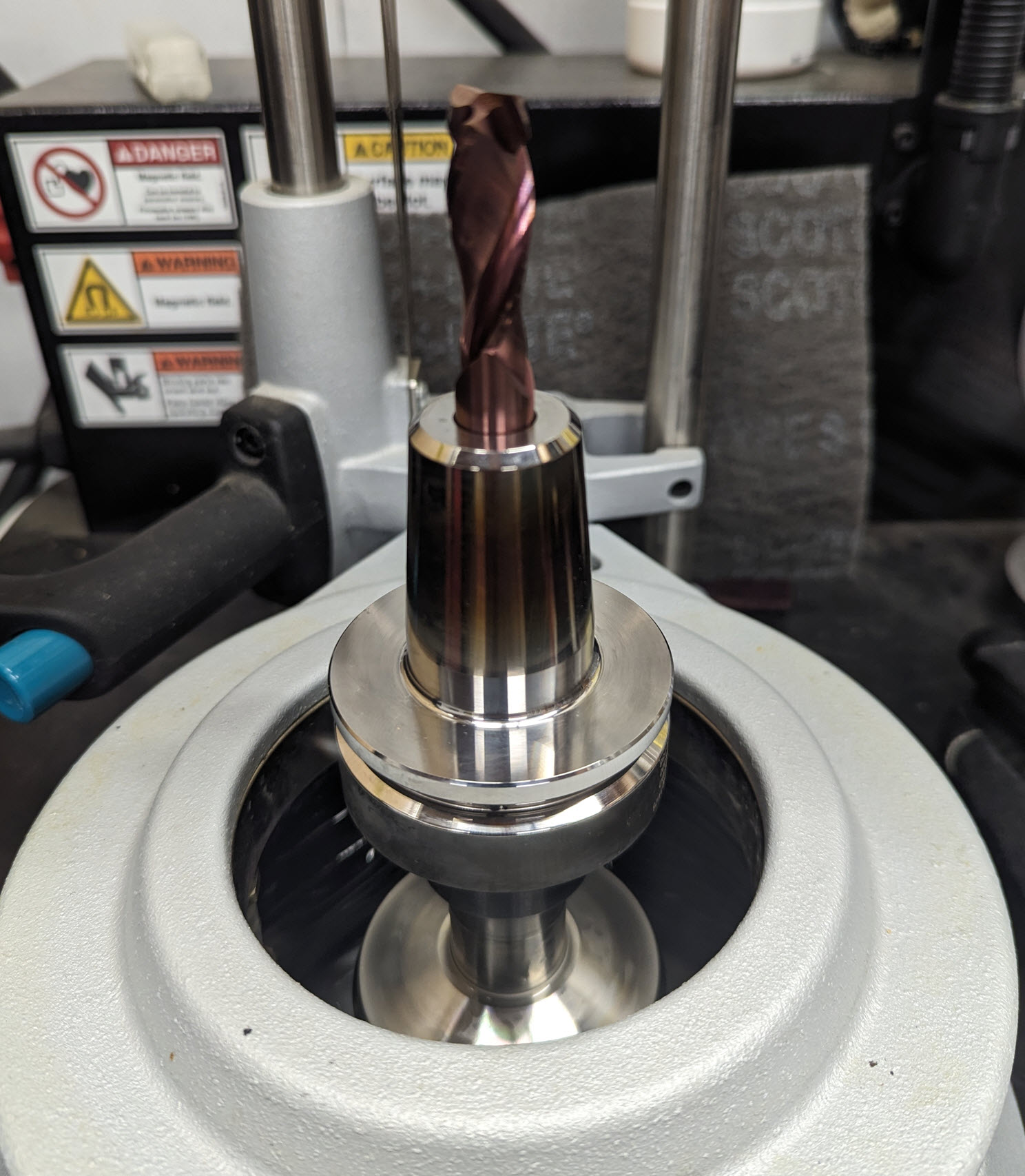

Use a heat shrink holder. Problem goes away, tools last longer.
View higher quality, full size image (1488 X 1706)

Chad, agree with you!!
