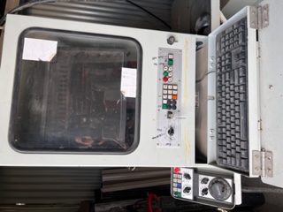

We just bought Selexx Eco few months back, been quite a journey setting it up. Learnt many new things as we are new to CNC world.
Tool #3 is stuck in the spindle, tried almost everything but no luck.
Also if there is anyway we can buy or D/L operating manual with how to clear out the error codes.
Any help would be much appreciated.

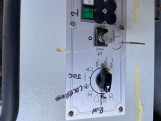

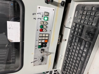

To get your tool to release manually, the machine must be in rapid or jog mode via the dial selector. Once the machine is in jog or rapid, press the button on the spindle to release the tool.
