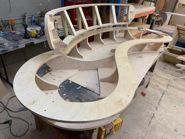

I am a cnc owner and I am looking to learn a new software to help me draw furniture like this
Any tips on what software to invest in knowing that I know aspire vectric
And polyboard
As well as Autocad
So I am looking for a software to make this task easier

I might be biased,because of a few years familiarity with it,but I would suggest downloading the evaluation version of Rhino-new version just launched.Very capable and not hard to find your way around it and I think it would be very good for the freeform curves in your example.I would stress the value of working your way through the tutorials that are bundled with it to get the best out of it.
I would add that the extra CAM module will allow you to program without having to export to a different file format and is quite easy to use.
