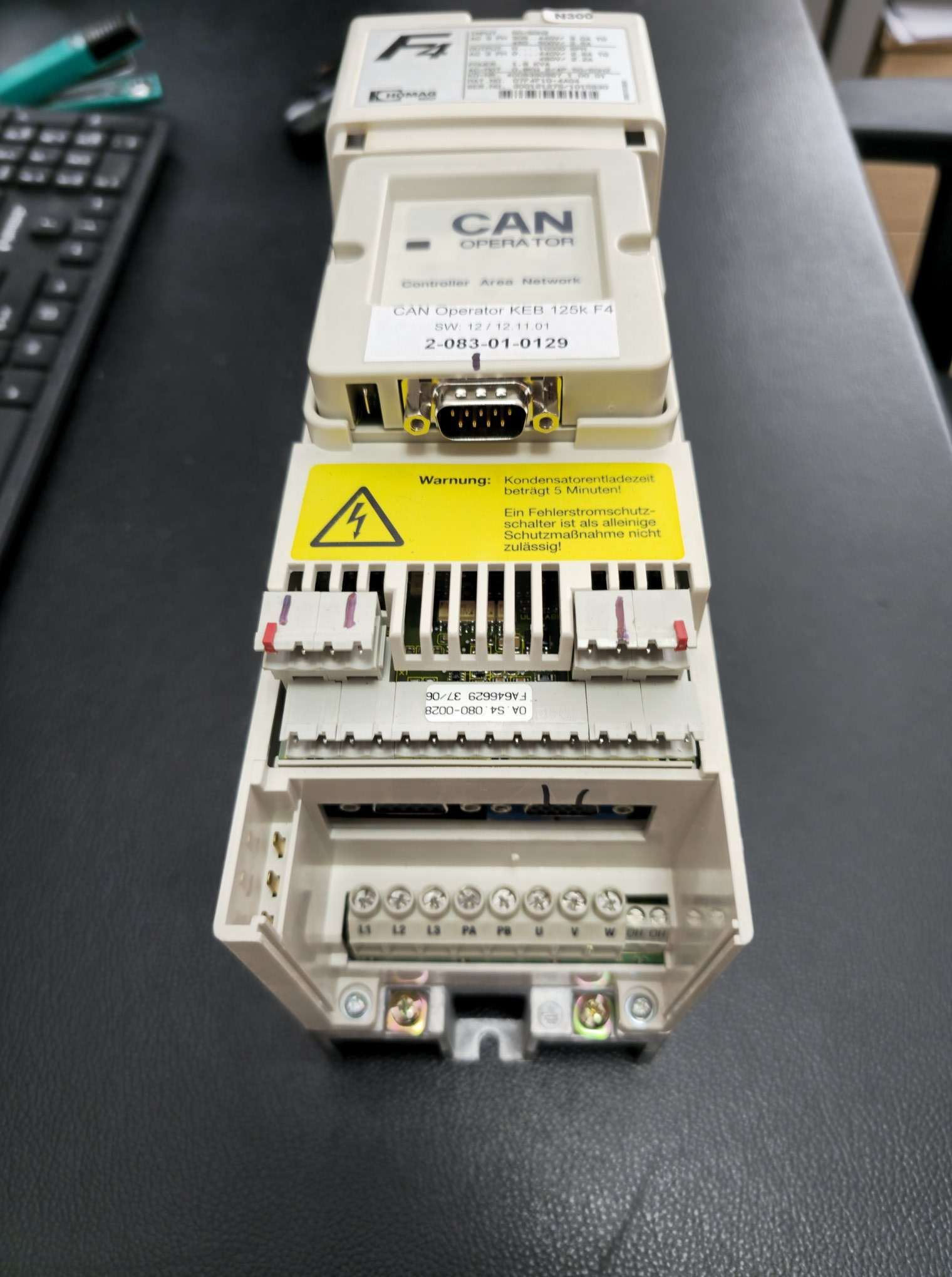

Hello,
Our machine is a Homag Venture 22L
The error that shows on the machine is "Malfunction - servo controller for tool changer"
HOMAG says We have an issue with our tool changer's inverter and that the solution basically is to buy a new one. We are trying to fix the inverter locally with a specialized electronic engineer.
We have changed the faulty parts of the inverter and everything seems to be okay. The inverter board was faulty and we fixed it as well as some other parts that may affected the inverter. All the errors are now gone except one. The error that shows up is E. UP which from the manual says it has to do with DC-BUS under voltage. Also the manual says maybe some other input current related problems. We have checked each and every possible issue with the input current and everything is as it should be/correct. Also we have checked the DC-BUS with the software COMBIVIS 5 and it says that it is okay.
My mechanic says this error should be an easy fix but it doesn’t go away and he is baffled.
Also, I would like to add, that, when we on purpose/deliberately OVERvoltage the inverter (800V+) the message E. OP comes up. And when we bring the voltage back down to 400v the E.OP fault resets and the
fault E. UP comes back.
Any ideas?

Did you get it fixed?
