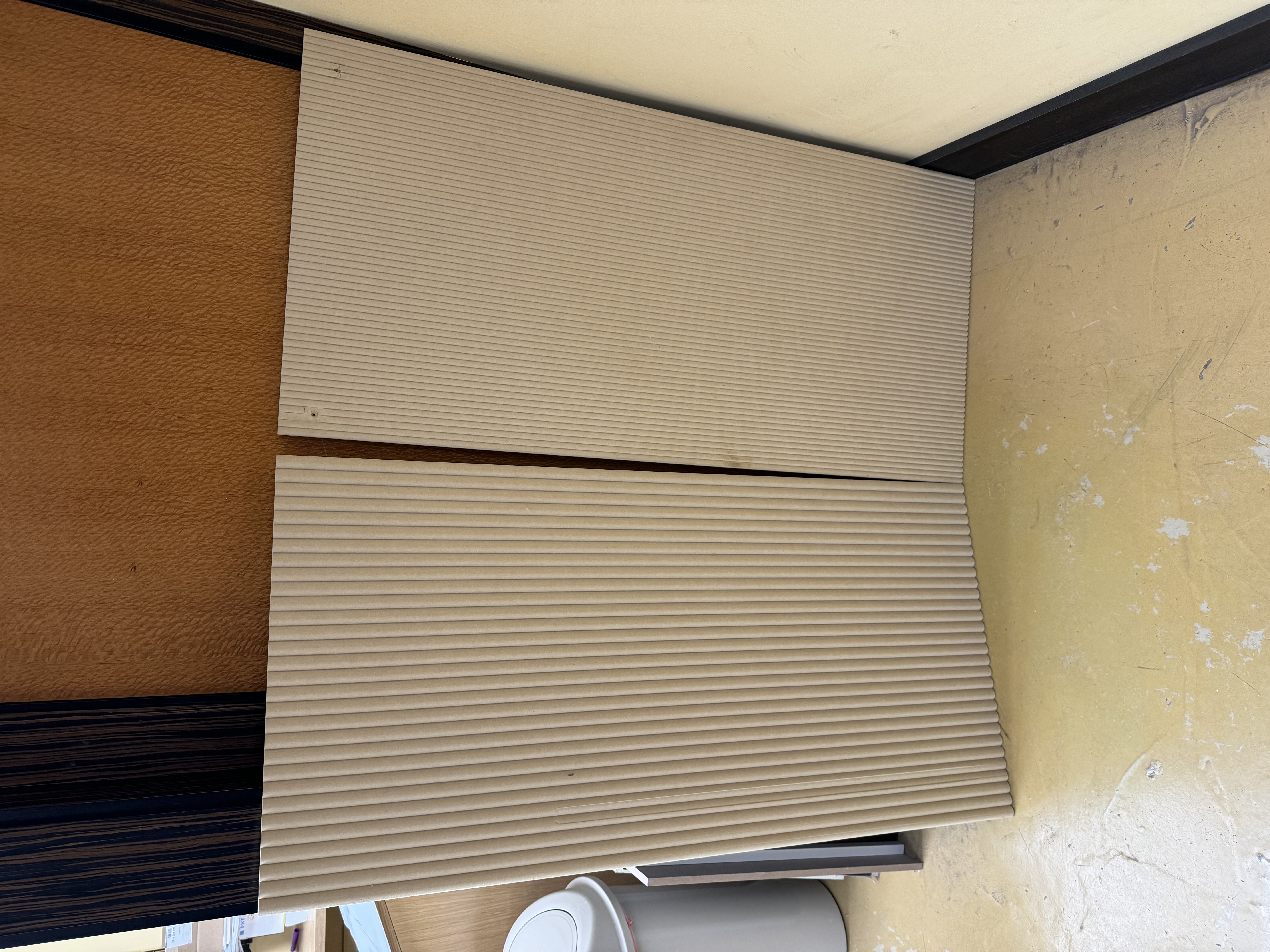

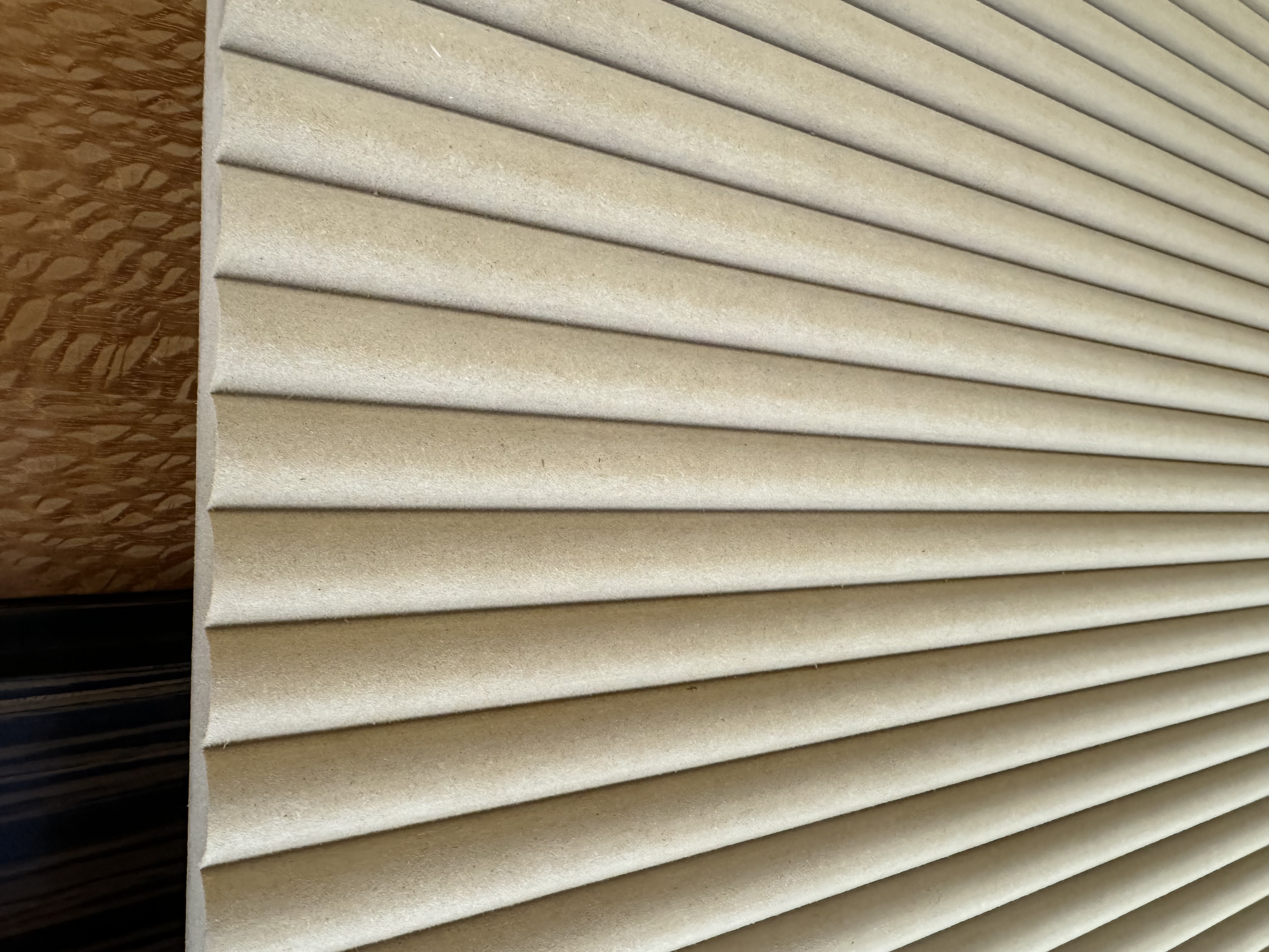

I am routing out 3/8" or 3/4" half round beads in the face of 3/4" MDF panels with the CNC machine. While doing so, the panels cup in width and length.
I would like to know how relief cuts are done. Are they done in a specific pattern? are they free hand?
What are the widths of the relief cuts?
Any answer will help for me to know what to do.

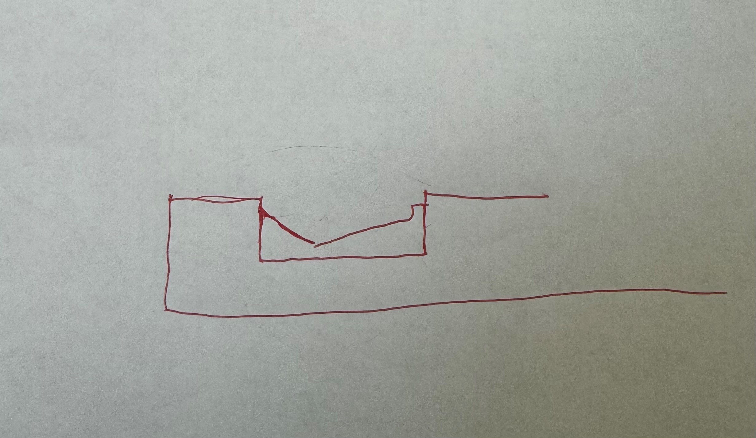

First, why are you posting the shape of your panel cut from the earlier post? Is there a connection between the two questions?
As to the MDF cupping that occurs because you are removing the stress skin from one side and not the other. You would need to remove a similar pattern of material from the back as from the front. Not the bead profile, just a fly cut style bit to remove an equal amount of the hardened surface.

I attached the beaded panels now.
