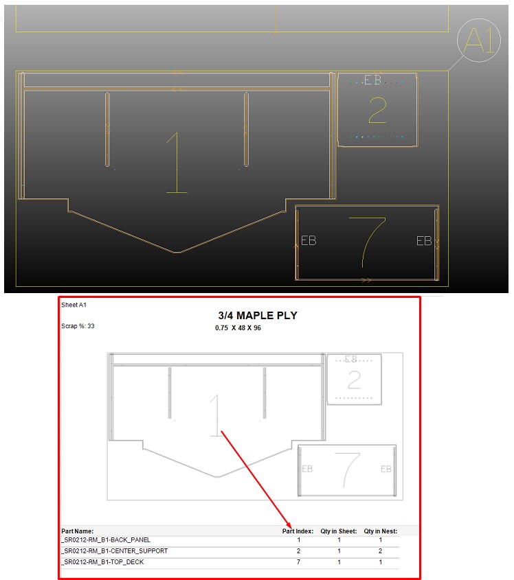

Where I work we use AlphaCam to program the CNC and AlphaCam throws a completely useless HUGE number on every part. I go and delete that number because it doesn’t mean anything to anyone and it takes FOREVER. How do I make it so it doesn’t put a number on every part? There’s gotta be a way.
3/12/24       #2: AlphaCam ...
Post a pic.
3/12/24       #3: AlphaCam ...
Almost all of my geometry is created in AutoCAD, therefore each part resides on a user created layer. I just turn all of them off. What remains are the Alphacam numbers for the parts. Now I can just use the delete command and big closing or crossing windows to get rid of them. After they are gone, turn my layers back on and resume. If you draw in alphacam without creating layers, just turn off you geometry layer and then delete. I don't think you can tell Alphacam not to assign a number.

3/21/24       #5: AlphaCam ...
Michael Lovejoy
Do you mean the item number that is used on the Reports and Labels? If you are not using just turn off or delete the layer in Alphacam.

4/26/24       #6: AlphaCam ...
Ian
Numbers are automatically assigned when using nesting functions
6/5/24       #7: AlphaCam ...
Pavel
Hi,
if you need remove it only from reports, you can deactivate it in the report's layout settings.
