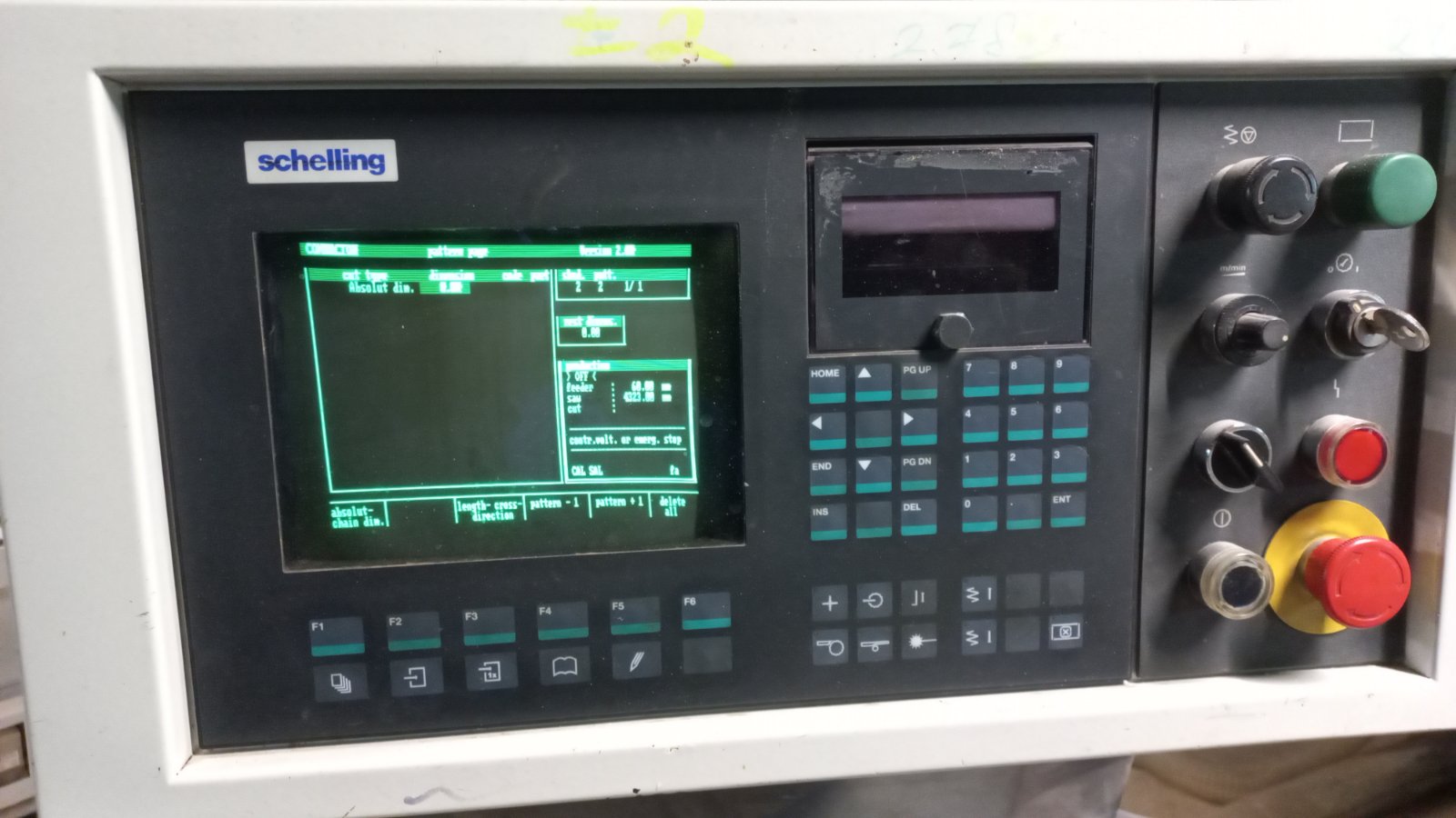

Hi all. I am sorry for my English. I use Google translator. A frequency converter was repaired on a format-cutting machine Schelling FI 430. Because of this, the machine was turned off for 3-4 months. After repair, when you turn on the operator panel, the message "Memory card, battery, exchange" appears. You can't work while doing this. After 1-2 hours the message will disappear and you can work. If you turn off the machine, the situation will repeat. I'm guessing it's the battery, but they couldn't find it in the control panel. Tell me what the problem might be and where to look for the cause. THANK YOU

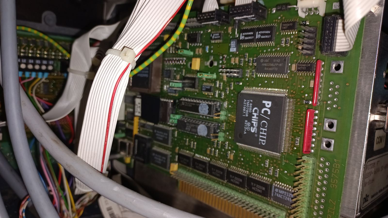

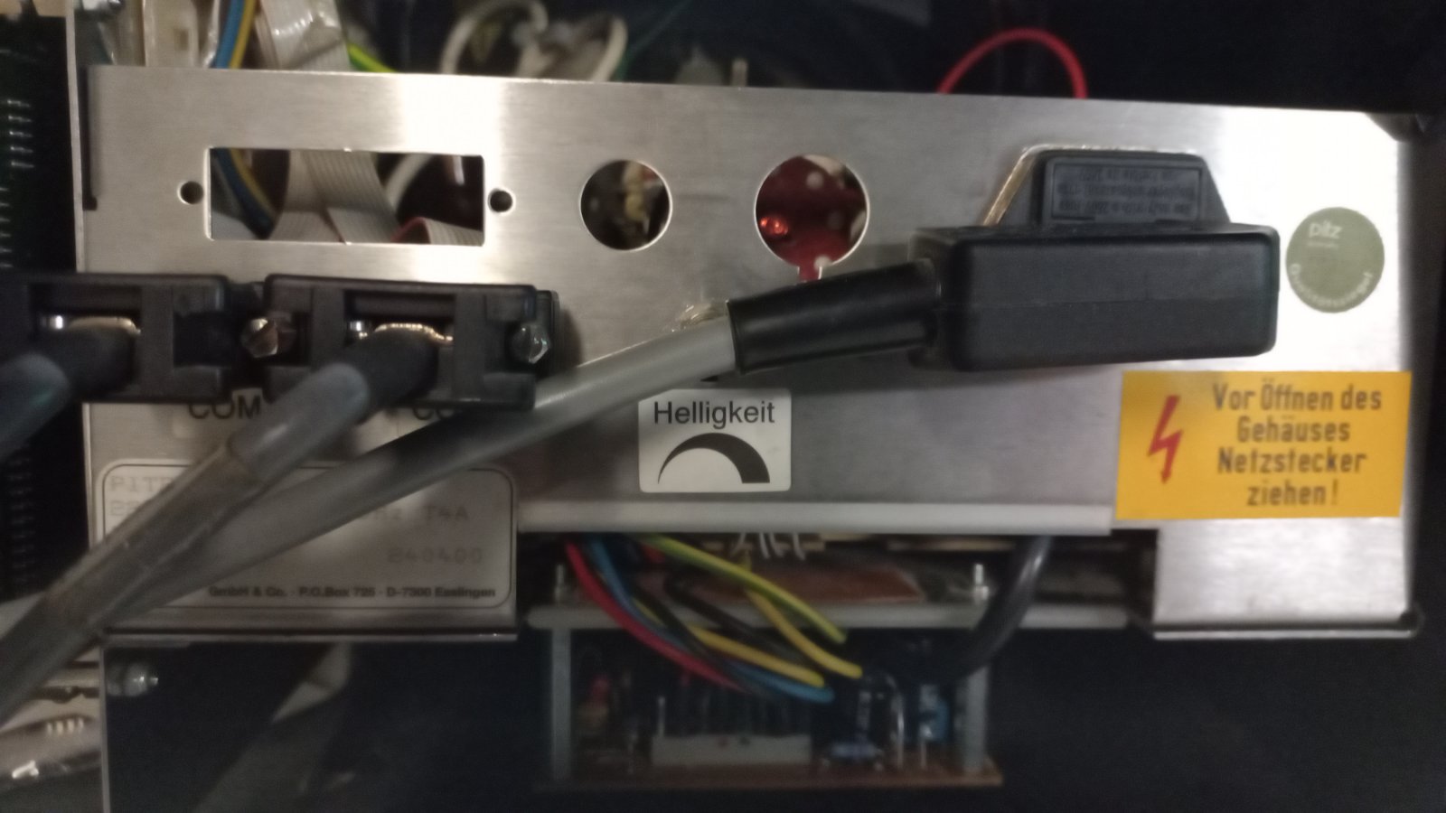

Additional photos:

I really can't help with the specific machine but motherboards in general use a 2032 battery. Look for a thin, round battery like the one in the photo somewhere on the control board(s).

One of my Biesse Arrows had the battery in one of the pre-programmed memory chips.
That was really annoying.

It sounds like the issue may indeed be related to the battery on the control panel, which could be failing or in need of replacement after the extended period of the machine being turned off.
