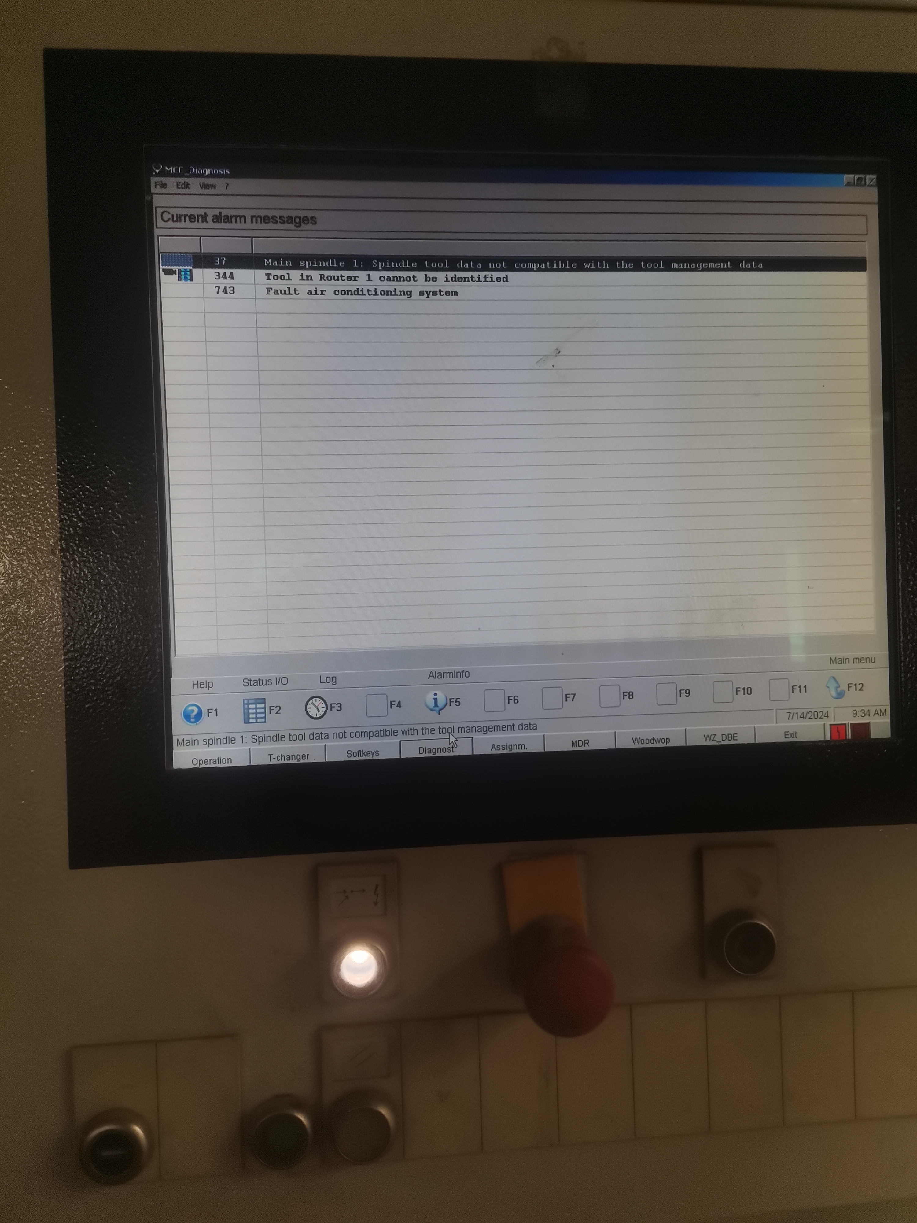

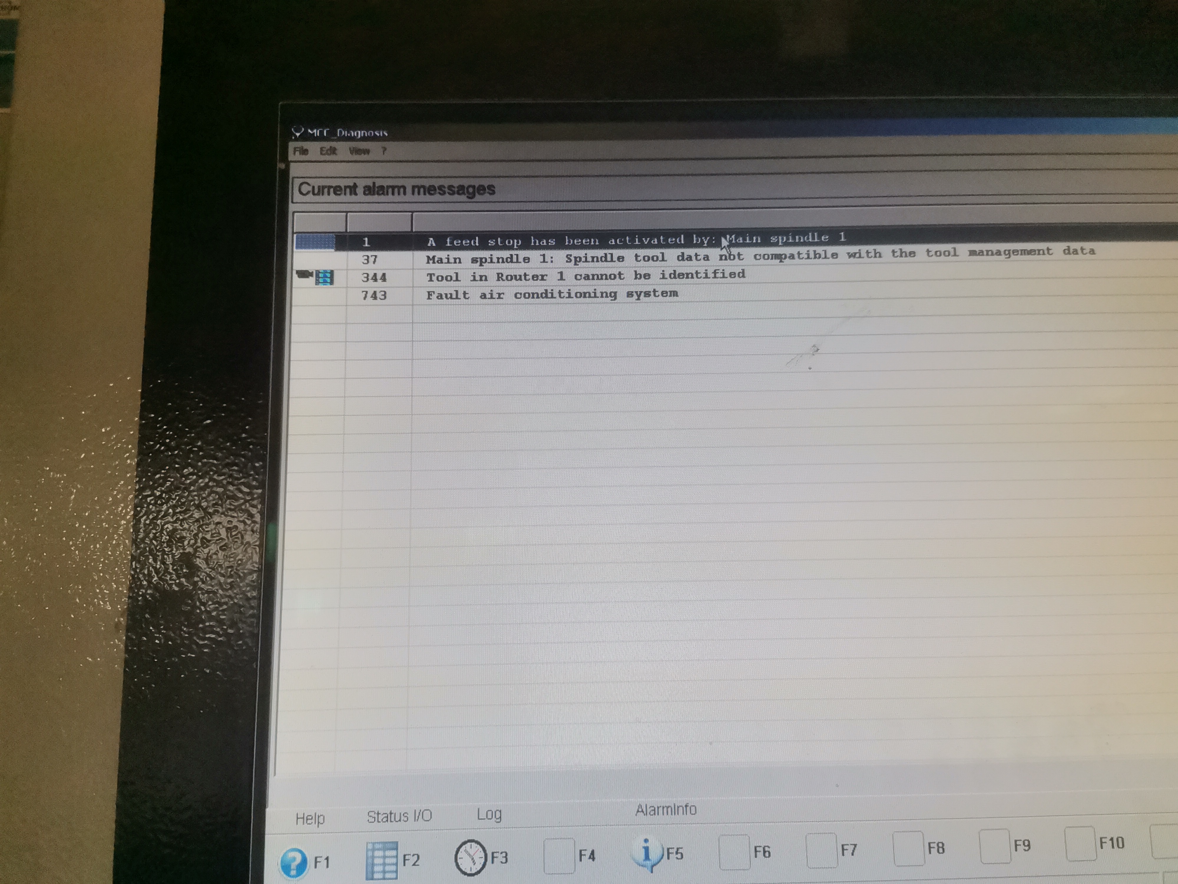

Mark Member
Website: N/A
How to fix this problem on Weeke Vantage 21s. Error Code 37 and 344
after I setted the tool number in a program it is missing /gone during running operation.

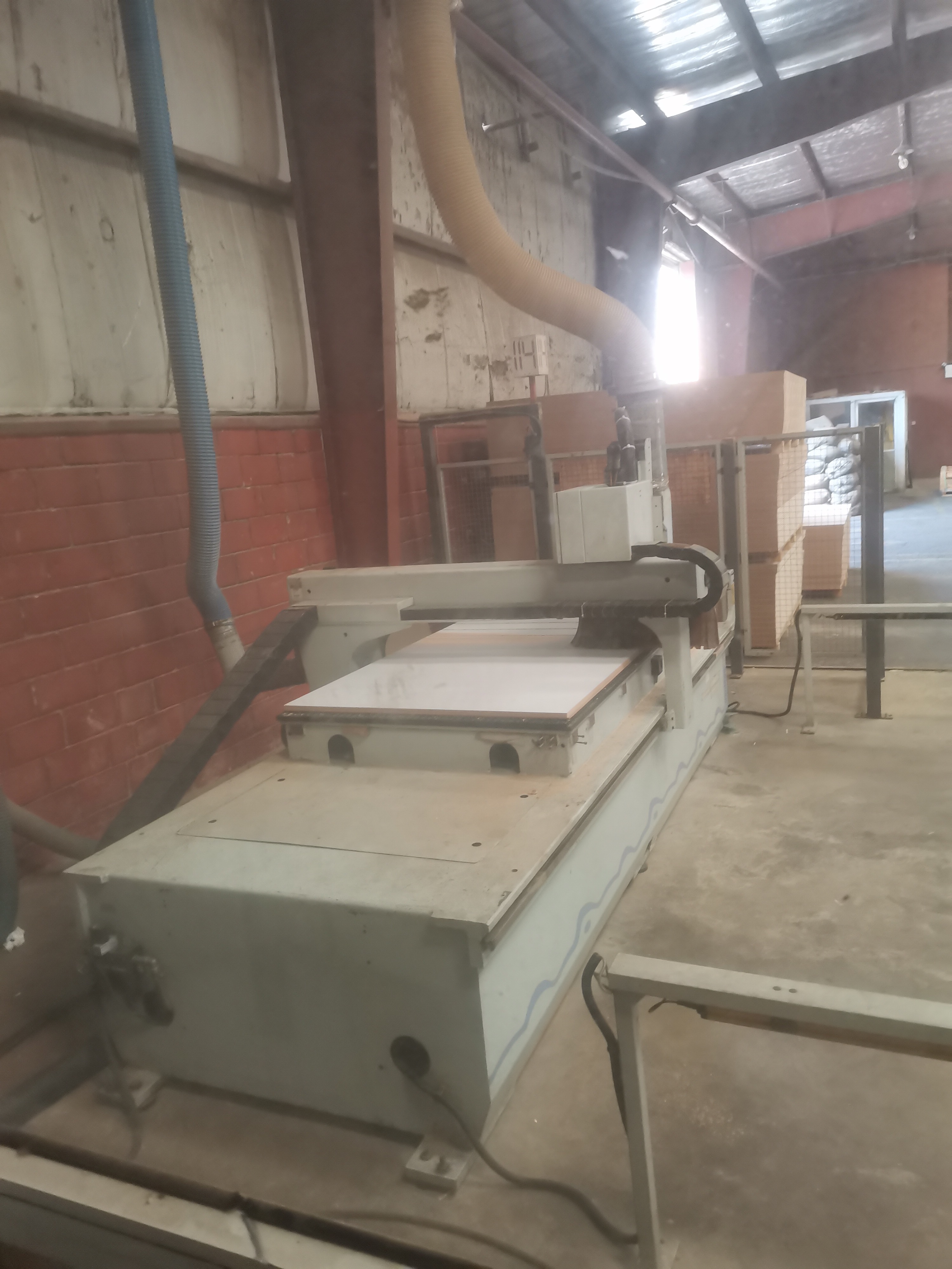

Michael
We have a BP 80 and when i try to use the pocket rout command i get a error code 93 , Trying to figure out the cause and reason and if it is something i can fix. Other then that the machine runs fine.
